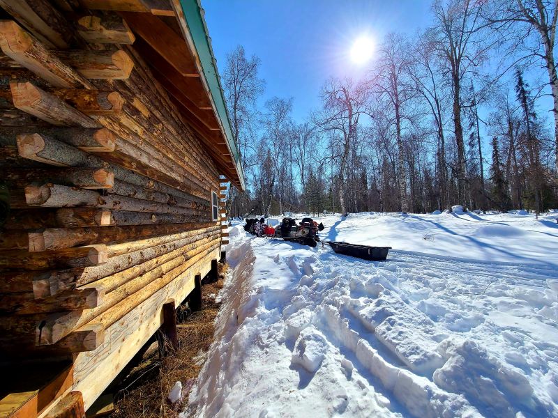

# Posted: 5 Sep 2021 11:38am - Edited by: Aklogcabin
On our cabin with 12/12 pitch I did mine 3' over . It was important that the snow does not pile up on the side of the building. I feel the further the drip line is away from the cabin the better.
On our house they are 6'. Leaving a nice dry storage area. We can see the mountains just fine. Starting to get termination dust now

# Posted: 5 Sep 2021 12:34pm
Nice finish work on that corner AK!
