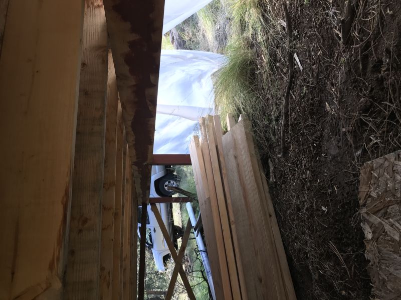

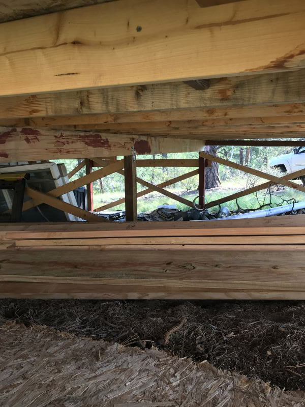

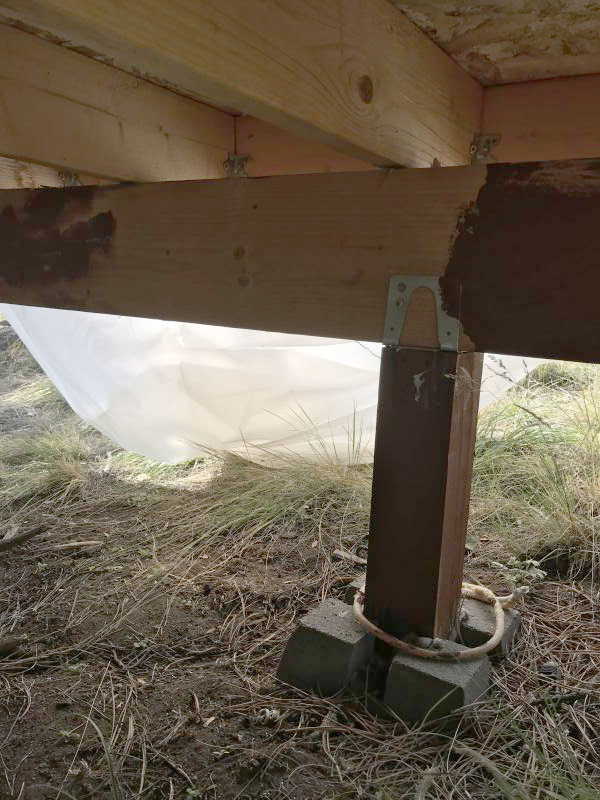

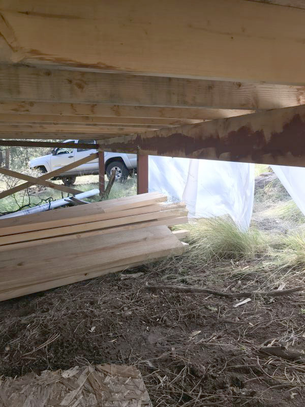

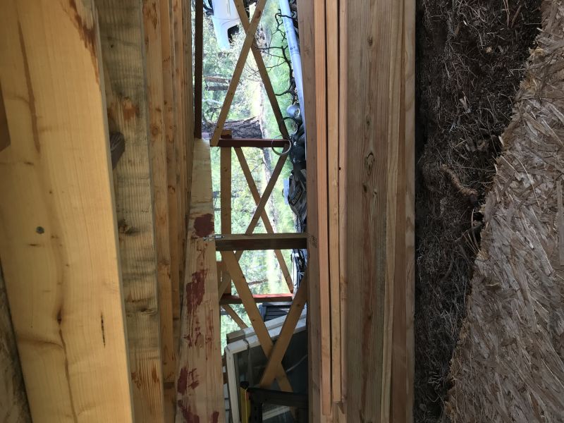

I could use some advice. Now I’m a little behind since I already did the joists, but is there a decision on how to strengthen the foundation of the walls before I put up the walls. I added some boards to strength the sturdiness of it. It was a little wobbly. Now it barely moves. This foundation has been like this for about three years. No problems yet. I’m not doing this per code. This is an off grid cabin just building for fun. It’s a 12x16 cabin. The rest is decking material.

Quoting: Kyle S
Foundations should never be even a little bit wobbly.
You have discovered why those concrete blocks sold as "deck blocks" should never be used. And, IMO, they should not be used for decks that are more than 1 foot, maybe two feet above the ground.

# Posted: 8 Sep 2021 01:34am - Edited by: DaveBell
Picture 1 Top soil was not removed. Deck block is now sunk half way.
Picture 3 Sinking cabin on hillside. Another Canadian sleigh ride and cabin collapse coming.
Picture 4 Deck block fully sunk and still sinking?
ALWAYS remove the top soil. It is not load bearing.
# Posted: 8 Sep 2021 01:48am
Quoting: Kyle S
Build it to code before someone gets injured or worse.
Jack it up on cribbing. Remove 6"+ top soil. Pour concrete footer blocks 12x12x6".

# Posted: 8 Sep 2021 08:52am
I did dig the deck blocks down about 1 foot. Added gravel and cemented them in to help with strength. So it’s not sinking. Just looks like it. I like adding a few extra areas with cement blocking. I can do that with out causing a bunch of demo. I’ll add 6x6s for those portions.
# Posted: 8 Sep 2021 10:12am
You can ads diagonal braces from each post to the one next to it in a cross pattern. That should help alot and shouldnt cost to much.
You basicly have a house of cards the way it is now. Theres really nothing keeping the posts vertical becids the horizontal board and it's not very good at that. The bracket at the top of the post only really keeps the beam on top of the post and theres also better ways to do this and cheaper, by notching the vertical post.
At least you used 6x6 and did some diagonal braces.

# Posted: 9 Sep 2021 03:42pm
