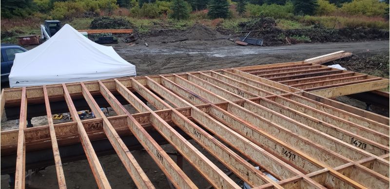

I used I-joists for my floor, and learned a lot by looking through the Boise Cascade Western Installation Guide. (Not sure on your locale, but they also have an Eastern Installation Guide.) I didn't actually use BCI brand joists as my local supply store has a very similar but different brand available. Dimensions and best practices were identical though. Regardless this should answer some of your questions about fasteners and methodology.
Here is a link to the Western Installation Guide - https://www.bc.com/wp-content/uploads/2018/09/W-spec-guide-BCI-and-VL.pdf
Not sure of particular joists you've selected as I haven't seen any dimensions called out, but 15' span is reaching the long-ish side of span for most of the smaller joists. You may have a slightly bouncier floor than expected.

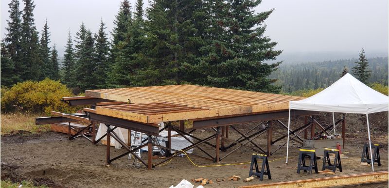

Personally I just end nailed my rimboard to the joists, and nailed my joists to the beams through the flange - no hangers. The only place I used hangers was where my joist direction changed and my entry butted up against my rim board (I actually double rimmed it in this area since I had the spare length left over).
I personally would highly recommend gluing the subfloor down. It is a cheap and quick way to add a great fastener to the build and make it that much more robust. The 28oz tubes of Liquid Nails Subfloor are about $5 each, and covered the joists and blocking for 3+ sheets of floor a piece. I especially recommend this given my earlier thoughts about the span.
I never saw you mention blocking between the joists. I hope this is part of your plan - where your joist cross your beams.

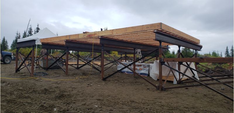

Thanks for the info Bradish! I'll be used 2x10" for both the built up beams and the floor joists.
BRADISH
# Posted: 14 Sep 2021 01:47pm - Edited by: BRADISH
Quoting: WILL1E
Ahh then I would agree that H1Z (galvanized) hangers would be a great method for the joist to beam attachment.
All other recommendations stand.
