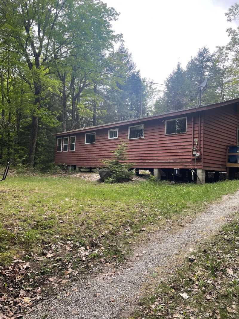

Hello all, new to the group.
Recently purchased a Cabin in Ontario, it’s currently a three season and I’m thinking of winterizing it to use as a Fourseason what’s the best way to enclose around the bottom of the cabin or is it better to leave it open and spray foam underneath the cabin

If spray foam under the floor is a realistic option then its the best one. No real need to enclose the bottom, in fact that ventilation is a good thing the other 3 seasons.
Spray foam is expensive, but also the best option if you can afford it.

My cabin is on piers similar to yours, although a bit higher off the ground. I bought some used 3 inch ridgid foam insulation from a local salvager, it had come off a school roof. Then I used the cut-and-cobble method to install it. It was a miserable job, mostly because all of my floor joists were installed at varying distances apart so I had to custom cut each piece of foam. I got it done for about $500 for 300 sq. feet and I'm happy with the results.

What's your water source? Where is the pump located? If there's any plumbing under the cabin you'll need to think about how to keep the water line from freezing (assuming you want to keep the water running all year). The benefit of enclosing some or all of the cabin is that water lines/plumbing/pumps etc can be brought into the heated envelope.
One other thing to thing about is whether rodents might have fun gnawing your foam insulation if it's exposed under the cabin. It might need to be covered with wire mesh?

Our cabin is on piers as well and we live there nearly year round. We live in high mountain but dry conditions, humidity/dampness under the cabin us virtually nonexistent.
Metal was used to enclose the crawlspace. We had the underside of the floor sprayed with 4" of closed cell foam... it made a huge difference in retaining heat as well as comfort walking on the floor. This fall we hope to have the perimeter metal sprayed too. We found that even in single digit temperatures under the cabin didn't drop below 28°F, we think if we foam the perimeter it likely won't freeze at all under there.
All of our water lines are foam insulated with pipe foam made for that purpose. Rodents have not chewed on this. The drain lines are wrapped in fiberglass insulation... done by the PO, the rodents have messed with that some.
Newer closed cell foam, according to the installer, has some compound in it that is disagreeable to bugs and rodents. We have had no damage.

We have a wood stove plus baseboard heaters. It has insulation, windows are single pain glass. Looking at replacing them in the future.
