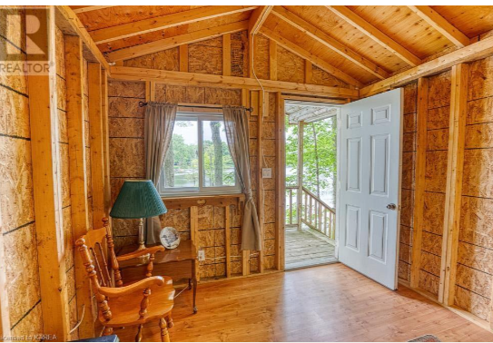

I recently bought a house with a small 10×10 cabin which has flooring and electrical outlets and lights, but is otherwise unfinished on the inside on the walls and rafters. I would like to insulate and finish the cabin for year round use in winters that get below -20. If it's way too cold we won't use it, but would be nice to use it most of the year.
I am a complete newbie to any Reno projects but have learned a lot from this forum
I am thinking foam boards between the studs in the walls and the ceiling plus canned spray foam for around the windows and doors, plus vapour barrier over the foam boards and then tongue and groove wall panels to finish it up. The cabin is lakefront probably with high moisture. I don't imagine the floors are insulated, but maybe that's a project for next year.
I will be heating the cabin with a small space heater (again we probably just wont use it if its way too cold. Im wondering if this plan makes sense and if I need to vent the cabin or if I'm missing any steps?
Thanks!

I uploaded a picture
Cabin
Cabin
