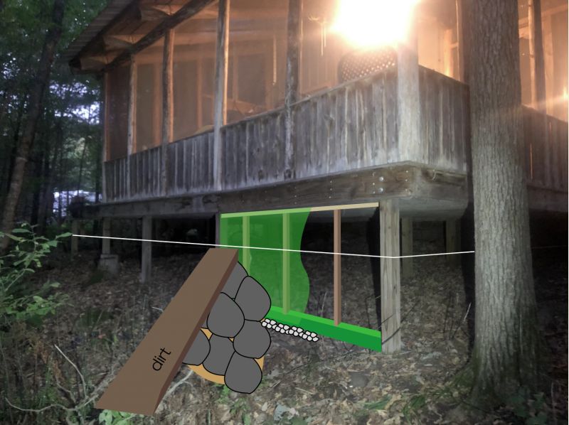

We have a purchased a cabin on a river last year in MN. The previous owner had it surveyed and he built it above flood plain at the time. FEMA has expanded their 100 year flood plain and our mortgage is making us cough up $1k a year for flood insurance. We are in the process of applying for LOMA. We hired a surveyor and we’re about 2 feet short of the ground elevation requirement that get us out of the flood zone. Most of it is under the screen porch which is decked with 5 1/2” boards. His advice was to skirt our screen porch and living space and backfill to get to the proper ground height. He’ll come out again and take the new elevation measurements to submit.
Our thought was to dig a trench a few inches below the concrete footings, add 1/4” wire mesh for critters and class 5. Run 4x4” Ground contact green treat horizontal from post to post, pound in some r-rod to help hold it in place. Frame 16 on center 2x4” with a 2x4 top plate attached to the joist. Skirt it with 3/4” Green treated for ground contact. Take basketball size rocks and packed with class 5 to help lock them in place. We’d keep the cheese wedge of rocks a few inches away from the plywood so there isn’t a ton of pressure pushing on the skirting wall.

# Posted: 16 Sep 2021 07:37pm
Here's a visual of what we're thinking

# Posted: 17 Sep 2021 07:21am
Your going to turn your posts into a retaining wall and that's a very very bad idea. Think about how much weight could push against those posts. Then theres the fact that once this is done theres no guarentee you wont have to get flood insurance.
If you really want to do something I see two options.
1) pour new sono tubes and make them as tall as the horizontal beam, then backfill all the way under the porch and possibly the cabin.
2) raise the whole cabin
Btw is that a visual effect or is the front of your porch sagging?
# Posted: 17 Sep 2021 08:51am
Quoting: Brettny
Brett is correct... you only have an insurance issue now. Pile rock and soil against those deck supports and it will eventually topple them. His suggestion of pouring new sono tunes is spot on. My guess is cost wise it might even be cheaper.
RJH
# Posted: 17 Sep 2021 09:42am
We thought of that, sono tubes under the deck would probably best and add dirt. But under the living part of the cabin we still want access to our plumbing under the bathroom and address the cold drafts that was freezing the shower's p trap under there. They built it more as a 3ish season cabin, we're trying to make it more efficient year round. The cabin is 18' wide and the ground is around 2:12 pitch. The crawl space under the bathroom would be less than a foot if we backfilled. We've thought of using landscape blocks with a lip and start the wall an inch from the plywood skirt, so there wouldn't be much fill and pressure on the plywood. Our worst case scenario is pony up for the annual FEMA insurance which is our lender's requirement
# Posted: 17 Sep 2021 10:03am
I don't think you will have a problem with it getting pushed in. Folks have built homes with aww foundations for years.
If you wanted to pour a small footer under the wall to hold anchor bolts through the bottom plate could add that.
I would recommend a good waterproofing barrier such as bitathane on the outside of the plywood. You are correct when adding the fill in to watch for any large rocks that can fall on to it and damage it. A 6 mil. visqueen vapor barrier on the ground under your living space will be needed.
And to also put a water barrier just under the surface of the ground from the new wall out 4 foot or so. Sloping away from the cabin to divert rain water. So that it keeps the area near your cabin dry. Rain gutters would also help.
