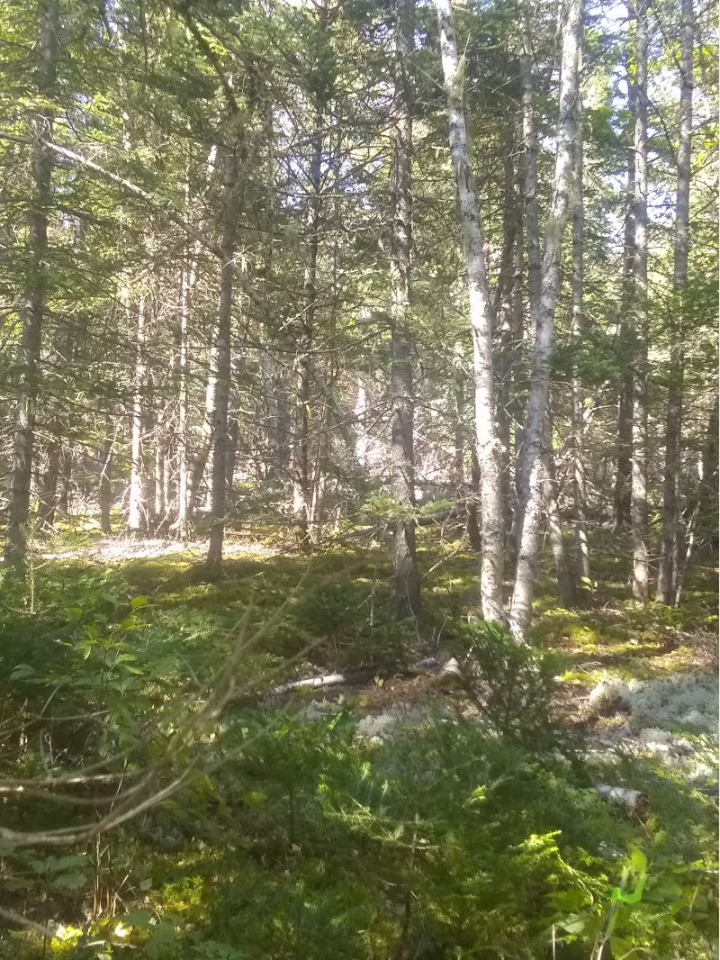

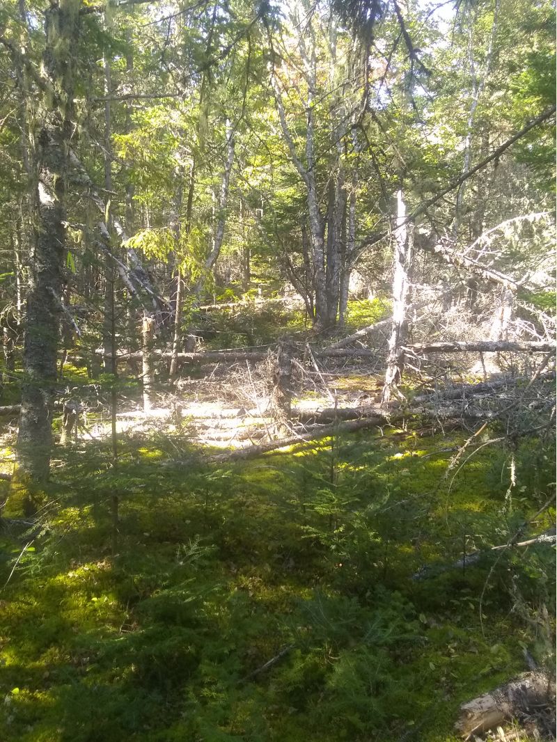

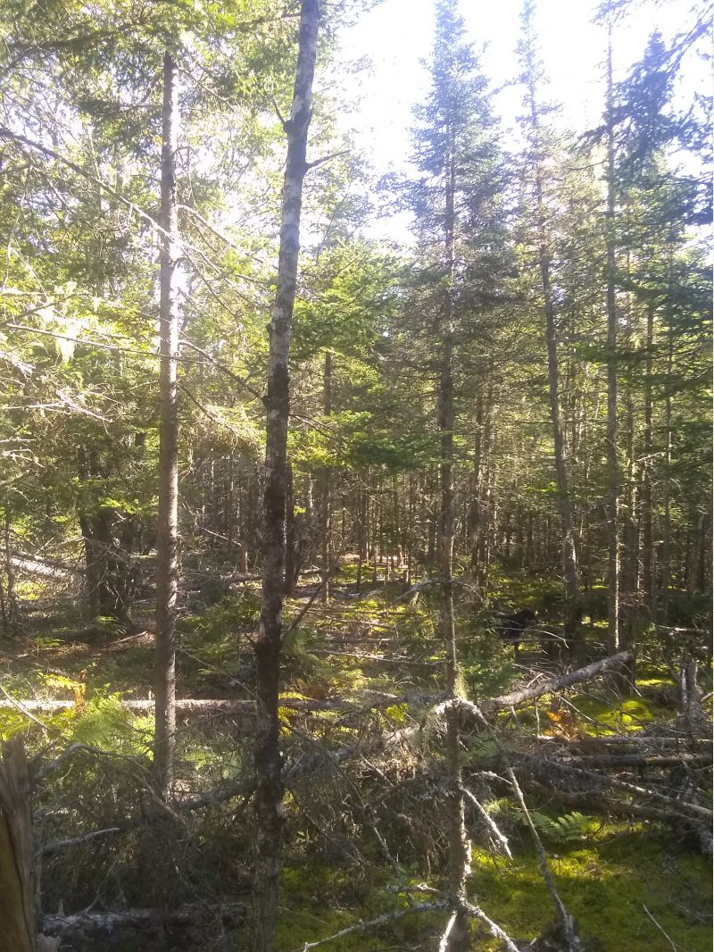

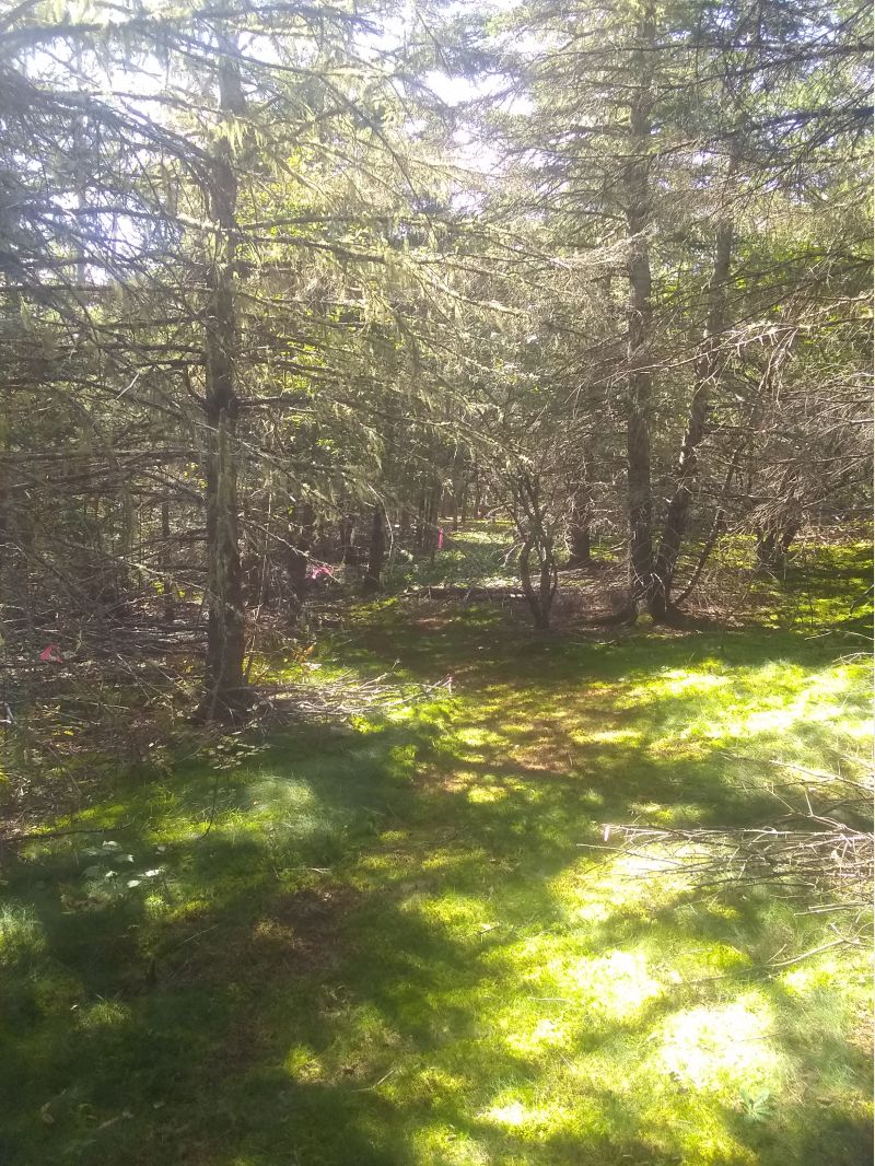

I hopefully atteched some pictures. So you can see the ground type I'm working with as well. Alot of dead fall around, tree roots at surface, mossy area. Again, limited to what I can work with an making the best of a situation.

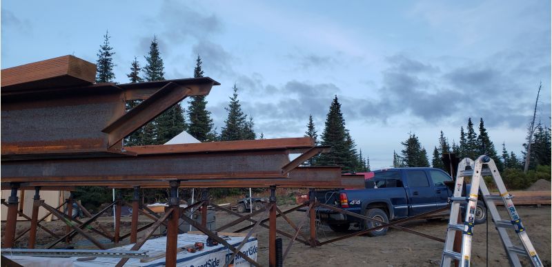

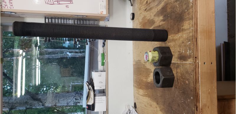

If possible you may try to source a means to jack the cabin on top of your posts if possible. I managed to find some very robust bolts from work that will perform this function for me if there is any movement (I doubt there will be though). Seen in place in the second photo under the beams.
