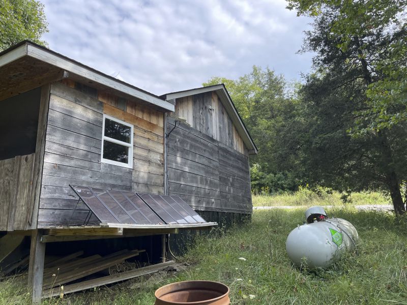

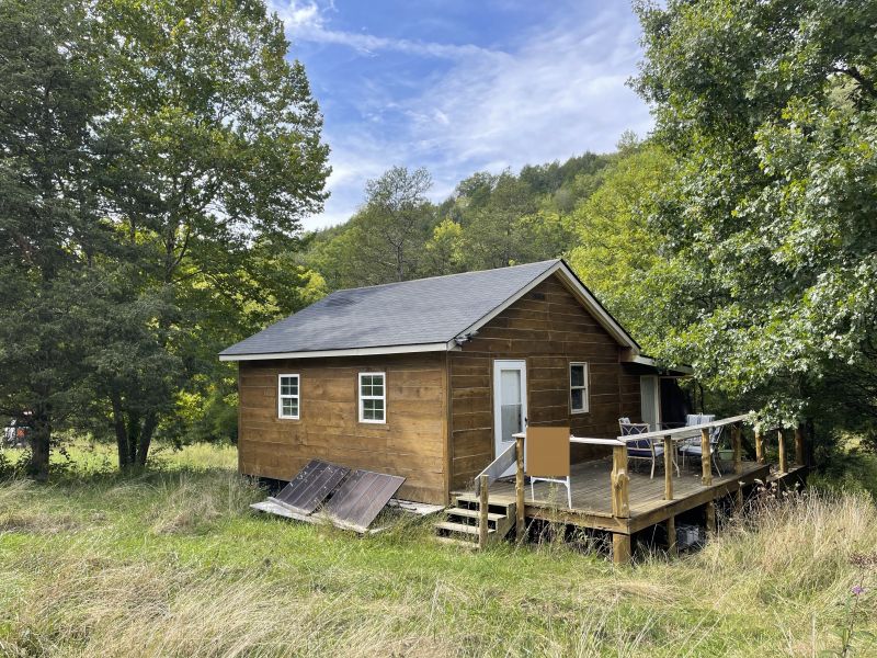

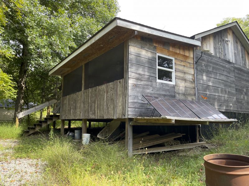

Hi guys, we recently purchased an awesome property with a small hunting cabin. The main room of the cabin is 20'x20 and it has a 10'x20' fenced in back porch.
The structure seems relatively sound, but it has quite a few issues. Since I'm new to small cabins, I sought out this forum to get some ideas from people who are familiar with this type of building and remodeling project.
I'm all ears and I would love to get some input into how/if I can turn this cabin into an awesome self sufficient off grid cabin.
In order of importance, I would like to do the following:
1. Metal roof with solar set up
2. Figure out what to do with the exterior siding. The siding seems to be barn wood with some type of caulking, but the caulking is missing in many areas
3. Sanitation. I'm thinking that maybe I need to build an outhouse of some type
4. Covered outdoor patio for entertainment, cooking, and work space
5. Rain catchment system

Can you tell me a little more about the way the boards are used for siding? It seems like the planks should be vertical with batten strips, instead of horizontal.
Between the boards is some kind of caulk but I'm not sure what it is or if it's worth redoing.
Under the siding is Tyvek and it seems to be in good shape.
Would I be better off taking the siding off and replacing it with vertical boards and batten?
I see what you mean about the roof mounted solar not being in the optimal position for efficiency. I'll look into a portable array. Do you have any recommendations for brands? I have a small renergy setup that I've been pretty happy with, but I'm open to suggestions.
With the roof, I was thinking that I would go with metal roof and feed the rain water into an above ground metal cistern.

My green sawmill random width boards were nailed up hor. too, then shrank leaving good sized random width gaps. We talked about 're-chinking' them (expensive!) but I agree, mounting vert. and battens would be better. Bet there is a good reason (or 2) that old farm barns were done that way?

When a property has sufficient space to place PV panels on ground mounts or pole mounts, that is, IMO, vastly superior to mounting on the roof. Not just for orientation of the array but it keeps you off the roof and means fewer perforations.
As for the siding, horizontal boards should be lapped like traditional lap siding. the upper board overlaps the top of the board below. That way water runs down and cannot seep into those horizontal joints the caulk is not filling properly. What you have would make a great underlayment for new siding. Either lap siding or if you really like board & batten, do it vertically over what is there. I would lap side, but that is my dislike for board & batten talking. I also like cement fiber lap siding but then I may have greater concerns about wildfires than you do in KY.

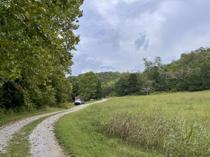

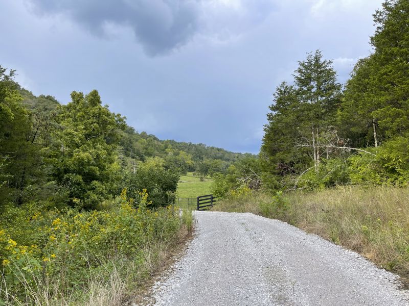

Stonnie - What's your access like to the cabin? Drive in, or ATV only?

I just looked up fiber lap siding and that looks like it would be great, if I can lay it over what's already on the cabin.

I have a pretty good gravel driveway right to the cabin.
After all these great posts, this is what I'm thinking:
1. Metal roof with rain catchment system
2. Fiber cement board siding
3. Generators for electricity until I'm more familiar with the subject
4. Covered concrete pad for bbq, work, fire pit, etc...
That might as well be a highway in my neck of the woods!
I'd say you've got yourself a heck of a place there bud.
