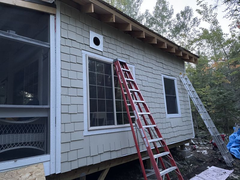

# Posted: 20 Sep 2021 07:53am
Thought I’d share this picture to help. Not a lot of room.
Irrigation Guy
# Posted: 20 Sep 2021 09:39am
After seeing the picture I think a longer piece through the thimble then hang the tee from the rafter tails
