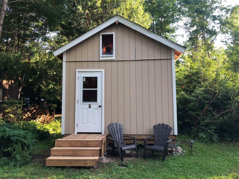

The last one I built I covered the whole bottom with pt plywood 3/8 in..I used pt. Peers and rim the rest was untreated. It was only 9 x12 so built it upside down to ease work underneath and then with the help of 3 friends flipped it over on the beams .You would need to build it in sections or nail it from under neath . Makes for easy installation of insulation, it makes a solid bottom to keep out pest also .not sure if it would work for you
