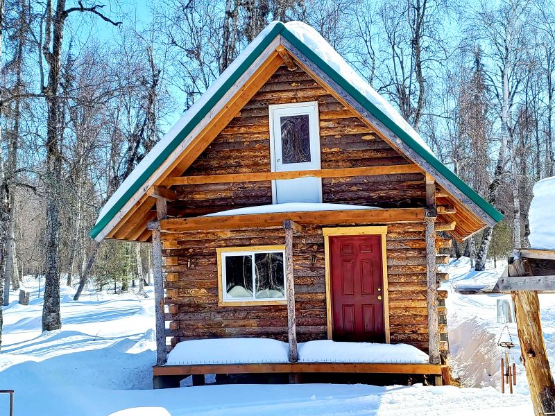

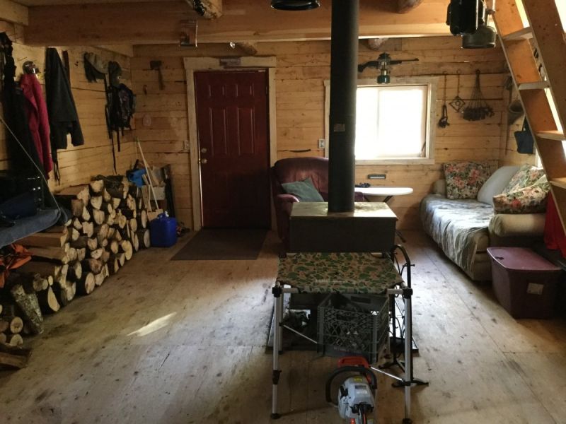

Yes we have a cabin made from 6" , 3 sided logs using that method of construction. I feel timberlock screws are superior.
I also enjoy the ombionce of a log cabin.
Not sure what you want but in the add they claim 12 plus years experience. Ask how many cabins in 12 years and the names or locations of folks in your area that may have one. Go look n maybe ask questions to the folks who have bought one what they think.
Some claim log cabins take too long to heat up or maintenance like log shrinkage is an issue. I have not had any problems.
I also did 10' high side walls . Then I have more headroom upstairs. Also have a deck upstairs. Really nice, and opening the window on the other end creates a nice crossbreeze for summer.
We did a full upstairs in our 16x24 with 4' wide decks. Really enjoy the extra space. I've read that some folks prefer a half or 2 split upper levels. As the downstairs feels small to them.
I prefer the full upstairs and have never felt boxed in.
Anyhows I really like the appearance of log , I feel it is much more bear resistant, a big deal for us.
I'll put a couple pictures up. More in my thread.
Good luck on your build n stays safe n positive

Beautiful sunny day
Beautiful sunny day
When you walk in
When you walk in
Front end
Front end

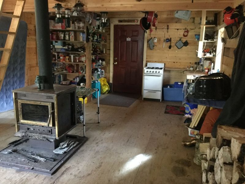

Upstairs
Upstairs
