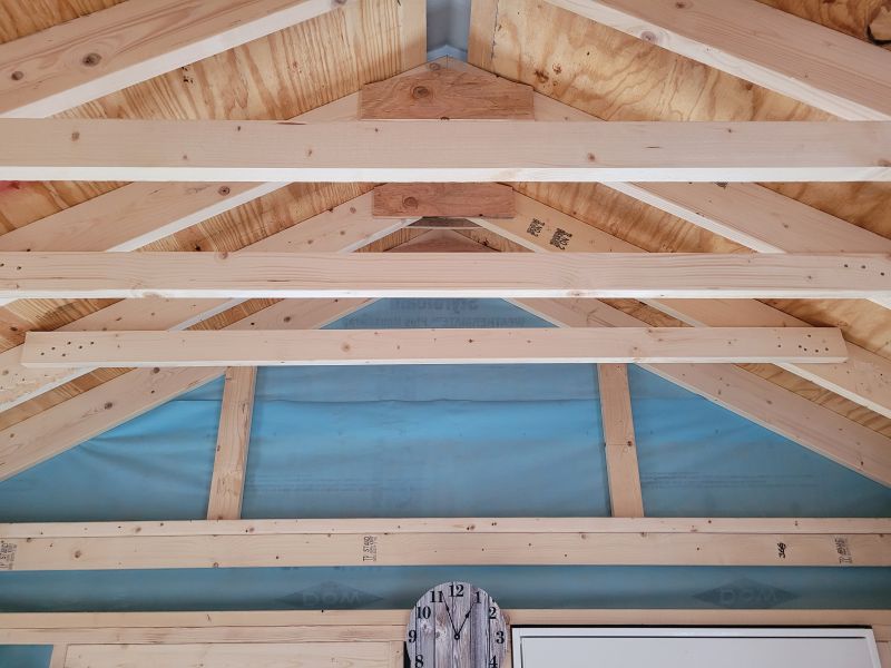

I’m going to begin insulating the ceiling in our 14x24 cabin next week. Rafters are 2x6 and I’m using R-23 Rockwool. It’s a gable-ended roof with the collar ties at about 9’. I’m planning to finish the interior with T&G boards next summer.
Originally, I planned to do a cathedral ceiling to the ridge and leave the collar ties exposed but that will mean a lot of tricky, for me, cutting of the T&G boards. If I finish the ceiling across the collar ties should I insulate all the way to the ridge in the rafter bays or go across the collar ties?
Second question…… I met an architect building a year-round vacation home nearby here in the northern Adirondacks. He told me about Intello membrane for the interior. Using it in a cabin is probably overkill but the architect tells me I could avoid installing soffit vents and 1x2s on the rafters to create a space under roof plywood.
Thanks in advance.
collar ties
collar ties
If you insulate up to the ridge, the ridge vent will allow cold air down to the ceiling. So go across the ties.

Quoting: DaveBell
The R-23 rockwool is 5.5 inches thick. A 2x6 is 5.5 inches deep. How will the soffit vents duct to the ridge vent?
If I go with the Intello I would not install soffit vents, would install insulation across collar ties and install insulation in rafter bays below collar ties. The insulation would be against the plywood roof deck.

You may get enough R value if you spray foam under the roof. However if you insulate to just the rafter ties it will allow you to really vent the attic triangle that's left. I have found ridge vents work poorly with cathedral ceilings.
# Posted: 24 Sep 2021 08:26pm
For 3 season with occasional winter we had NO insulation in a cath ceiling in s-central Wisconsin for 37 years. 5.5" of insul in my 2x6 rafters would have been luxurious, as it was we kept the wood stove idling along and did fine, sometimes living in there in shorts and t-shirt at well below freezing.
I had intended to insul.....then lost my 'roundtuit'; once we found out we could do more than just barely Ok there was no rush, lol.
On yours Id make everything above the collar-ties a mini-attic, fill the lower rafter sections with all they will take and at least that much on that 'attic' floor and have gable vents as mentioned. Bet you will be cozy.
