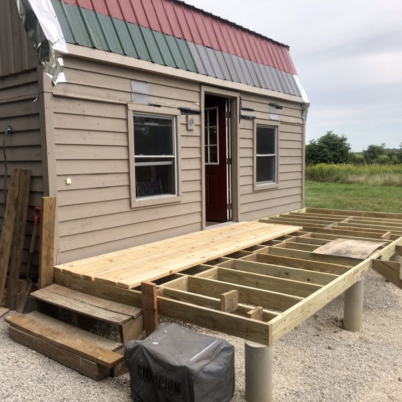

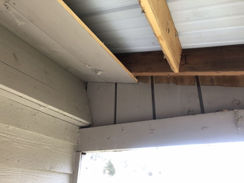

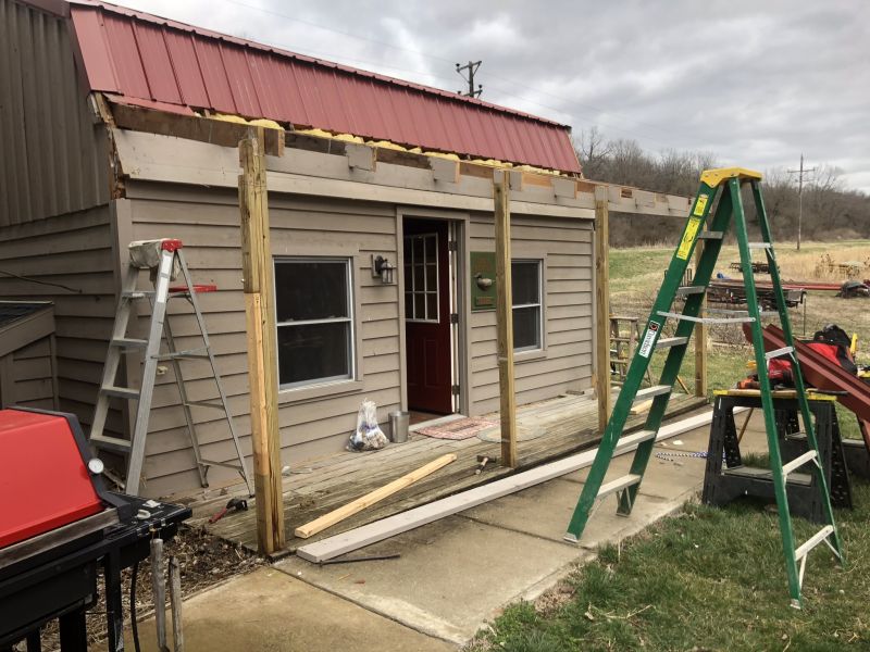

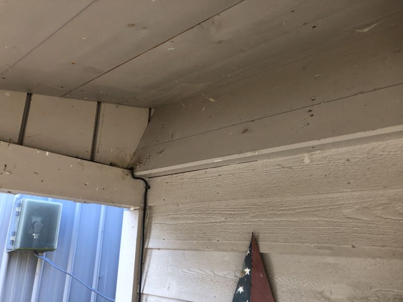

I just added an 8’x20’ deck onto a cabin I just moved. Originally it had a smaller deck with a metal roof, metal was screwed directly to rafters without any insulation or underlayment. Owner screwed stained 1x10 pine to bottoms of rafters as a ceiling/bird blocking. It is 6 years old and didn’t show signs of condensation drips on rafters, probably from the pine ceiling which insulated it somewhat. I’m not wanting to use 1x10’s as a ceiling on deck and leave it open but am concerned with condensation drips if I don’t insulate....but all the fanfold and 4x8 insulation panels I can find have writing/logo’s on underside. Options that I can think of are 1) use synthetic roof underlayment it’s black underneath 2) skip the insulation and put up with drips 3) buy more pine and install a ceiling 4) open to suggestions! Thanks from central Illinois
