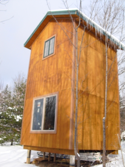

Neb;
I had a similar desire for a fast build of a place to stay infrequently. I built a stick frame with 2 by 6 and covered with T1-11, insulated, and covered interior with 1/8th" luan ply. No tar paper, no plastic wrap, no multiple levels of exterior covering. Granted, I did a lousy paint job, but the T1-11 has stood up to its first winter and seems fine. It was an absolute breeze to put on with a nail gun and a second pair of hands.
Good luck!
