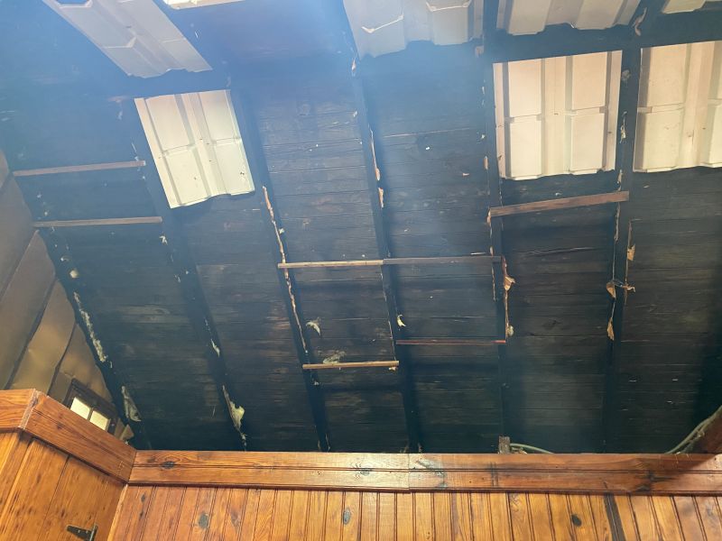

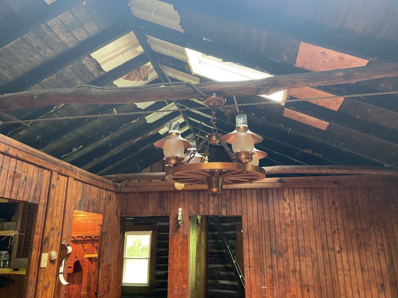

That said, I'm attempting to attach pictures of the roof. I still haven't been able to get back in the house (im under real estate contract so I have to wait on realtor) but these pics will kind of display the roof structure. You can see two large logs spanning the roof in the center of the cabin. I'm assuming these are what the original builder thought would suffice as rafter ties. If I can find a source for logs, log rafter ties would look awesome but I unfortunately want to move this project along so I think i'm sticking with dimensional lumber...

# Posted: 7 Oct 2021 11:00am
Welcome to the magnificent obsession!
Hmmm, wonder if those logs are an 'afterthought'?
And how are they attached at the walls?
Also wonder if the rafter size is adequate to the snow loads?
Before purchase Id want to get side to side and end measurements to find if the walls are bowing out.
Hope you are getting a steal of a price, or at least the price of replacing the whole roof deducted. This IS a big deal.

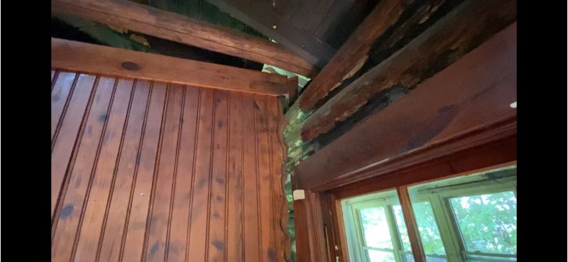

Anyhow, I found a "better" pic of where at least one of the logs are "tied" to. The log wall has clearly moved outward as seen in the pic.
Now that you mentioned it, those 'rafter tie logs' were probably added years later as a last-ditch effort to keep the walls from completely pushing out. The logs are interlocked at the ends but they've still moved nonetheless. :::gulp:::

I also missed where this was a log cabin. Theres almost no pulling the walls in on a stacked log cabin like that. If you do you may just be pulling the top log in and your wall will still be bowing. I wouldnt get involved with this major of a job unless your paying for only the land.

Looking at the pictures, I am not sure if its a sagging roof pushing out the walls, or bowing logs taking the roof with it?

In the picture of the walls separating there is a window. It could be removed. And a beam placed outside running vertically up n down the exterior. Better with 2 beams .one on each side of the window. Or a hole could be cut through the logs to run a cable through. Near the center of the wall such as 4' up from the floor.
After it is pulled in. You can use the window opening again. I've seen where door openings can sag out. The door is frame removed. Then the wall pulled straight. May have to use a tree outside as a base to jack against along with a post to push again the bowed wall. Then use a cutting edge off a graded blade. Cut a line down the center of the logs to recieve the rigid piece of (rustolium painted so it doesn't rust) steel. To work as a spine of sorts.
