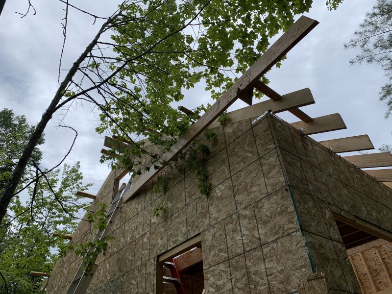

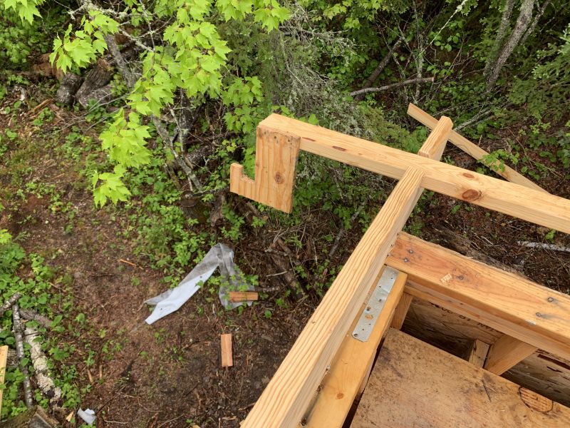

# Posted: 12 Oct 2021 11:59am
I know asked for pics Brett’s method from above… but I thought I’d share how I did the fly rafters myself. The this was actually very easy with the “bracket” I made from OSB. I nailed it to the lookout. Then lifter one side into bracket- and the walked other side up to ridge board. Just as easy as the other rafters.
# Posted: 12 Oct 2021 12:21pm
Genious!
I Sooo wish I had done flys on my 1st build in '83-'84, always regretted not. Just a little bit more work and material.
