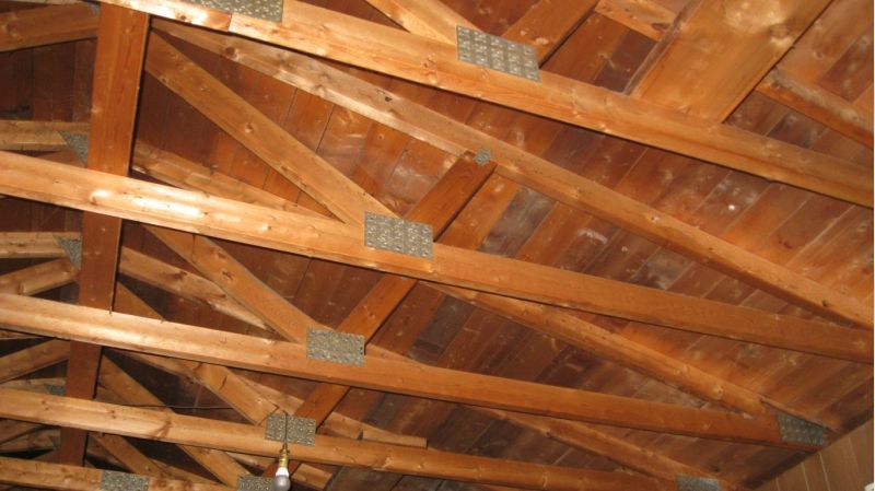

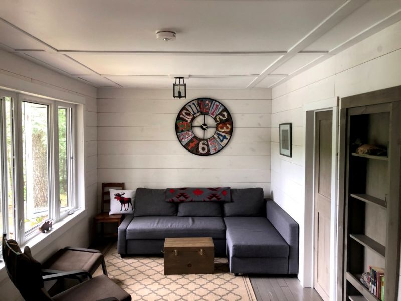

I bought my cabin about 6 years ago and have been slowly rebuilding it. It had bare rafters when I moved in. I decided to put a ceiling in so that I could insulate. I decided against drywall for the same reasons as you. I ended up put up a thin sheet of painted plywood (about $15 for a 4' x 8' sheet). I was able to handle the materials pretty easily. Then I ran some MDF slats to cover up the seams.
Quoting: NorthRick
Fire. The idea behind sheetrock or thicker wood is to give you more time to get out in the event of a fire before the roof collapses.
I put my ceiling in without thinking about the fire code. After I had it up I came across the fire safety of drywall. If I had to do it again I would probably go with drywall for that reason. My cabin is tiny so you are never more than 6 feet from a window. Hopefully if there is ever a fire escaping won't be an issue.
Ceiling Before
Ceiling Before
Ceiling After
Ceiling After

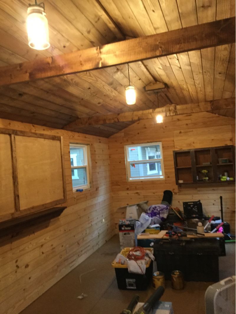

You might check Craiglist. We have a place here in NC that remills 2x stock into lap and T&G. You end up with one slick side and one rough. They also have #2 that they sell. It has knot holes and splits but when I did our celing I did not have much scrap because I could pick and choose each board from the bundle. Not what you would want to do on a paying job but works on a DIY.
https://raleigh.craigslist.org/mat/d/wendell-factory-2nd-knotty-pine-tg-pine/73955520 02.html

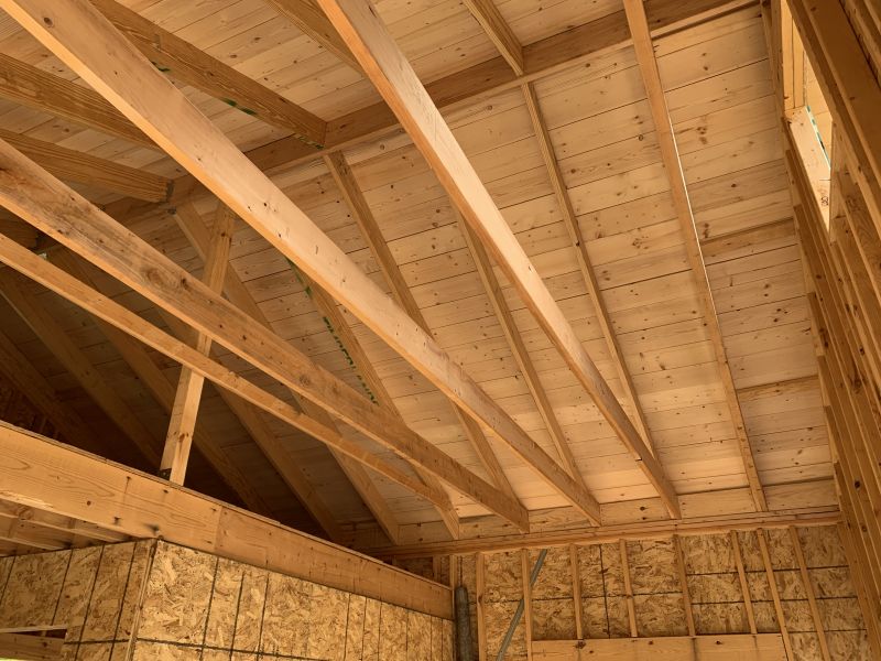

Keep in mind- it doesn’t have to be t&g. You can just use 3/4 boards… or even 1/2 boards. I did my ceiling with 3/4 8” 14’ long boards.. rough sawn on one side from menards. I bought these in January when prices were lower but I think it worked out to only a little more than $1 per SF.
Now mine is sheathing for the top of the roof but I don’t see why you couldn’t do it the other way. I kind of like the gaps… granted I have tarpaper on top of it so it’s black between them.
