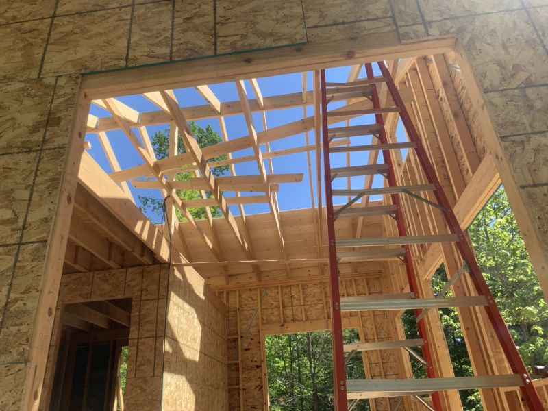

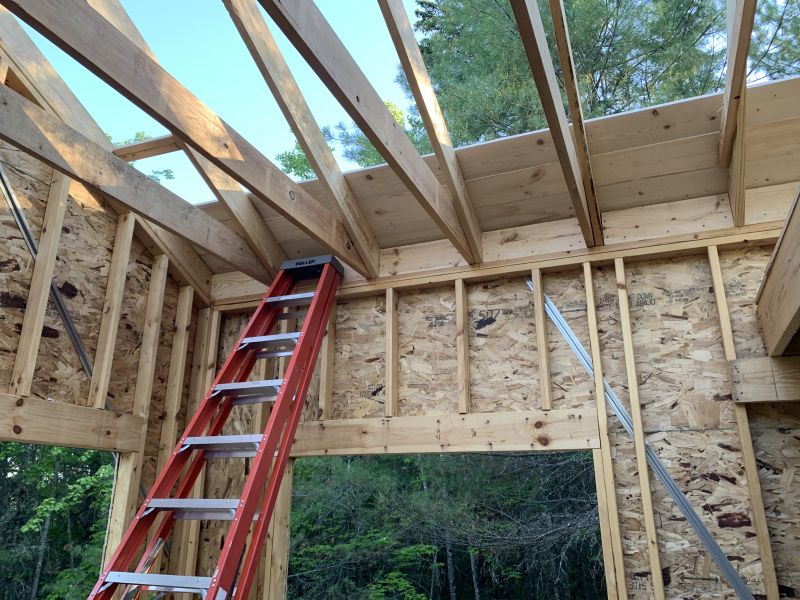

I used 3/4 boards and did the same thing. You can find rough cut pine board that are rough on one side for less than typical boards. I bought 14’ lengths. I put the rough side down for texture on my ceiling. Did exactly as you described with ladder from inside. How high will you be working?
I ran into a problem eventually where the ladder wasn’t high enough and it was just easier to go up on top after a while of working my way up the roof. Even if the ladder was long enough I probably still would have gone on top.
I didn’t gap them much… they’ll have natural gaps that keep them apart anyways. I did it in the summer though too…so they had more humidity than now. It’s not real dry yet though… so not sure what to tell you about gaps… but I wouldn’t gap them personally and even if I did I’d leave just a little gap.
Just something to think about as you put the plan together.
Also- If your boards are longer than the height of your roof you place several standing up on leaning on the edge of the roof for easy access and nail multiple in place for each trip on top of the roof… that’ll cut down the ladder trips
