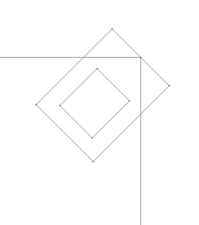

I'm planning on going with the ComfortBilt HP50 series pellet stove. It's going to be installed at a 45deg angle in the bottom right corner in the floor plan i have attached. I am going to put the vent and fresh air intake on the gable wall. I have all the info from the manufacturer about how far off the ground, from the window, etc. for the fresh air intake and exhaust vent. Once the exhaust pipe exits the cabin, it will go about 3' vertical and then exit whatever exhaust tip i go with.
1. Cabin only has housewrap on it. They said i should put a temp piece of siding of some sorts for where the thimble comes through the wall. They said a 12" till with the thimble in the middle of it. They said as long as the exhaust pipe is 1" off the wall going vertical and then the exhaust tip terminates 12" from the wall i should be fine. Any thoughts about that from ya'll?
2. Inside isn't finished or insulated at all. Should i put something like cement board behind the stove on the walls for temporary? Their install directions don't say anything about the walls having to be non-combustable, it just tells me how far away it should be from combustable walls.
3. I don't want to spend $500 on a corner hearth pad from them. Right now i just have the bare subfloor and i don't know what our floor is going to be yet. What's a good low budget hearth pad that would get me by for now, that i could either build upon or easily change later on? Their pads are 1.125" thick, but i'm not sure what it has to be...i only know how big it needs to be footprint wise.

2: As long as you're maintaining the clearance from combustible walls, I'd just put the insulation in for now and move forward......
3: Manual just says ember protection only, so no R value needed to be met on the floor.... So a piece of sheet steel on the floor is something I've heard talked about as cheap/easy on hearth.com. You could tile it, but that gets trickier to get done in these temps. Looks like Fleet Farm sells "stove boards" which are like 32x42 boards for $90.

Sheet metal (could be used stuff, doesnt have to be pretty topped with some 12"-18" tile squares from the Restore (Habitat for Humanity resale shop) with a border strip to hold all in place should do.

Found this, think i'll go with this and then notch one end so it can fit in the corner.

We just used concrete board on the floor as a temporary hearth. If you use multiple pieces its best to thinset the 2 pieces together with fibre tape. It will keep any errant the embers from falling between. However, its not such a big deal with a pellet stove. Its cheap and easy to get from any big box store.
There are a ton of ways to accomplish this though. Its just temporary... BUT you need to make sure its safe.

The manual does state that it needs to be on a non-combustible floor such as a hearth pad, but it does not spec a thickness, R value or any specific materials other than non-combustible. It does call out how far the non-combustible floor/pad needs to extend from each side of the unit.
The manual also does call out how far the unit needs to be from combustible surfaces such as the walls, however it does not state anything about those surfaces needing any special protection assuming those distances are adhered to.

Yeah, as long as you meet those clearances, you could put whatever you want on the walls....which is why it doesn't tell you anything else.
Then it does need to be on a non combustible pad if they spec the size of pad.

For $80 i'll just buy that pad and notch it to fit the corner install.
