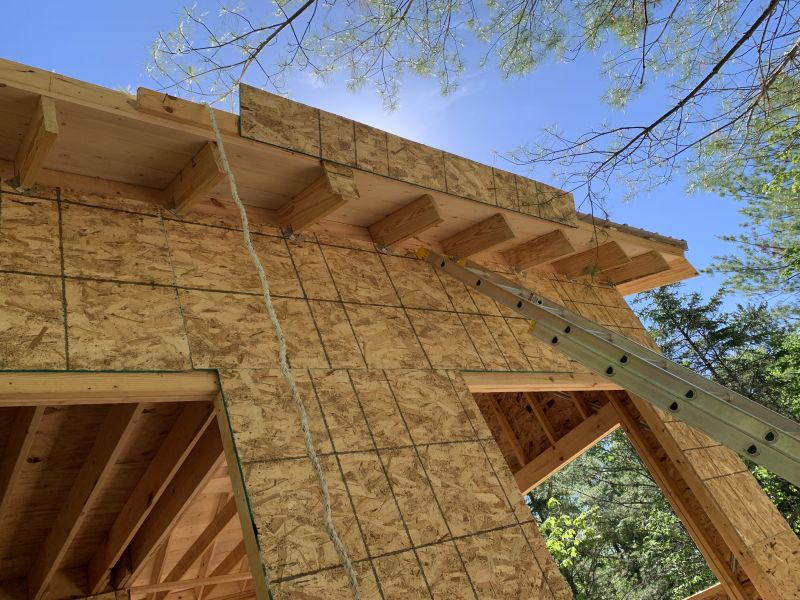

Here is how it finished off. I hope it's not thought that I'm showing off or anything, but some of the details I faced I thought were worth mentioning.
For instance, if you notice most pole barns, the rake end of the metal is left open. I decided to close it up by creating flaps that folded down over the opening to keep the larger critters out.
Also, at the end of the ridge cap, most will just run it out there and call it done. It's a little nicer to fold it down and fit it perfectly over the edge. Once again, more time, but it keeps the critters and weather out.
If you have soffits, you might appreciate using the vented stuff. I have a cathedral/vaulted ceiling that's insulated, but has a 2" air space above the insulation to let air pass from the soffit all the way to the ridge vent, which has a mesh or filter media under it.
Also, another thing I can say before I shut up, is that they make closure strips for under the ribs. At the bottom edge of the roof, install these between the felt or membrane and the underside of the tin. They fit the rib profile and stick into place before you place the tin. That will help keep critters out as well.
Okay, I talk too much. I'm finished. Sorry.

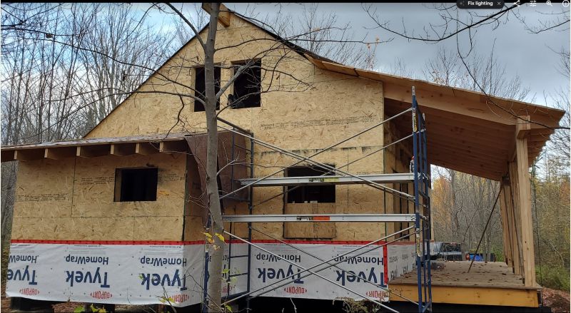

Here's where i'm at as of last week, like WILL1E, i'm running out of steam after working on this all summer
eventually when it's more complete, i'll post a bunch more pictures to show all the progres

this screenshot didn't display on last post

Very nice!!
If you did the sheathing and paper yourself, you should be able to handle the steel without a problem. Therefore i would just call it quits for the season and attack it in spring when you're roaring to get out of the house after being all couped up all winter. Don't be afraid to use some adjustable roof jacks or nail some temporary boards into that roof to give yourself a decent place to stand/work.

It looks to me like you will be able to place an extension ladder on the backside that will lay against
the roof to finish off the tin. It does not look like
fun. Good luck with it and be safe.
