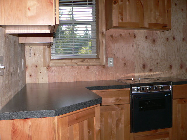

Thanks Bob. It went real well. I'm about 98% done now. Just a sink and floor covering. Here is a picture of the formica. I did lots of research, spoke to my cabinet designer and he walked me right through it.

nice looking job----great place to cook some meals for years.

Good looking job, t-m-t. Glad it worked well for you!

Looks good better then my real home. Nice work.
