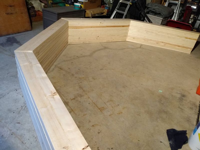

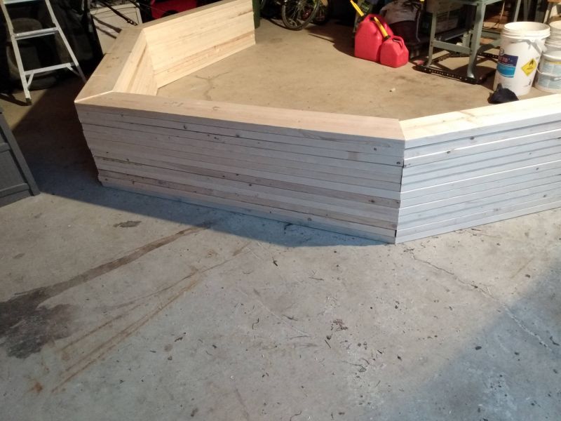

carlveil
# Posted: 9 Nov 2021 11:13am
Rafters
carlveil
# Posted: 9 Nov 2021 11:24am
Quoting: travellerw
The plywood gussets at each hip aren't the prettiest to look at. You would probably have to step up to sanded one side ply.
Definitly a challenge There. About costs, i think it wouldn't be much more. Tongue and groove over the rafters, membrane,1 1/2" foam, 2x4's flat vertically every 2' with 1" foam in between then furring strips horizontally and metal roofing. Anyways this will be for another thread.
travellerw
# Posted: 9 Nov 2021 01:18pm
Quoting: carlveil
Rafters
Looks great..
When its time to assemble make a jig on the floor on sheet material. Make sure your jig keeps the rafter legs secure AND THE PLYWOOD ON BOTH SIDES AT THE HIPS. (I did not do that and every piece of plywood at every hip is just slightly set different. Its hard to see with the eyeball, but if you put a straight edge on them its very clear.)
Mark the lower legs (left and right)! When putting them up ALWAYS keep left and right to the same side of the cabin. No matter how well you build your jig there will be small variances between the sides. Doing that will make all the rafters on one side the same and you won't see it.
I'll be interested to see your results.. Its kinda like a SIP panel construction with rafters below.
(as an aside, I have been researching glue for foam as I want to make a laminate sandwich for the floor. Great stuff pro construction adhesive is the winner. Its bond is insanely strong.)
