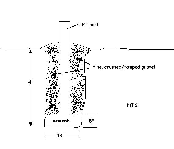

Hey Just, is this what you recommend?
I'm likin' it...but not sure about my soil situation.
Lotsa pumice (sandy) here and quite dry....but down to minus F° in winter.....

# Posted: 19 May 2011 10:18am
Quoting: Just
code in Ontario Canad
I'd like to see that reference simply because the IRC (code in most of the states) actually totally avoids any mention of pier foundations because their success is very dependent upon soil conditions that are unpredictable at best. I am currently working with a structural engineer and the more I see, the more I see ways of things going wrong. I have seen three cases of piers shifting out of vertical alignment. One case only took a year.
