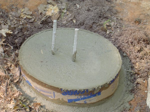

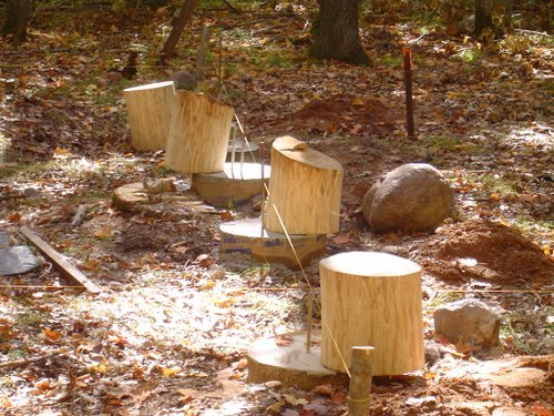

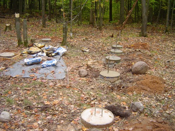

I like footings with stumps on top. Makes leveling things much easier. In my case, I dug out below the frost line and filled the holes with sack-crete, rebar, and rock. I put 6" of sono tube at the top just to provide a place that is level.
The holes were about 20" in diameter and belled out as much as I could with a manual hole digger.
This foundation was all done by hand after hauling everything three miles back in the woods.

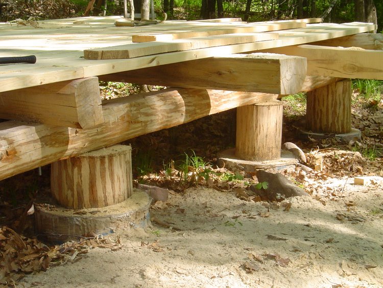

# Posted: 18 May 2011 11:45pm
Are the stumps just sitting over the bolts? A potential problem with that is the lack of uplift resistance.
fpw
# Posted: 19 May 2011 08:18am - Edited by: fpw
I drilled a couple of holes in the stump and set the stumps down on the rebar. The cabin is a log cabin with 12"-15" diameter logs (about 700# per log when dry). It will not go anywhere.
Solid Foundation
Solid Foundation
# Posted: 19 May 2011 10:20am
Okay, for a log cabin that would take a cataclysmic event to move. However, I would not recommend it for a stick build, which is more common.
