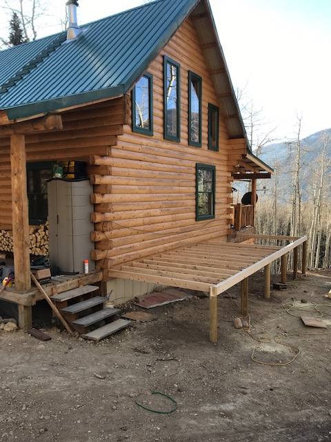

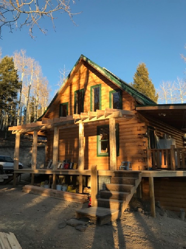

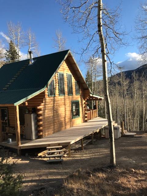

Well.... I was done with projects for the year (other than the water trailer skis... more on that next week), but..... the weather has been so good that we got a jump on next Spring's projects.
Day 1, Hired a local guy to come up and help me dig the holes for the piers, 6 holes ~3' deep. An all day project in this rocky, nasty soil.
Day 2, Neighbor came up and along with my wife, we set the pier posts, got the main rim joist in place and a lot of the joist in place.
Day 3, Neighbor and his wife came up and helped us and before sundown it was pretty much finished!
Still have to finish screwing down the decking... most of that is done though. So next spring we will put up 5 x 8" peeled logs to hold a 2 sided log beam to support rafters to cover the main portion of the deck. We got the logs cut a week ago for that. Then of course railings...
Edit.... and log siding around the deck. Replace the window with a 5' slider... move the window to the left.
Anyone have pictures of rustic railings they want to share? We don't like the railings on our back deck and we're thinking goat panels.... 4" heavy wire panels.... trapped between an upper and lower 2x4, but sure open to other ideas. Would love lodgepole pine pole railings but no lodgepole in our area.

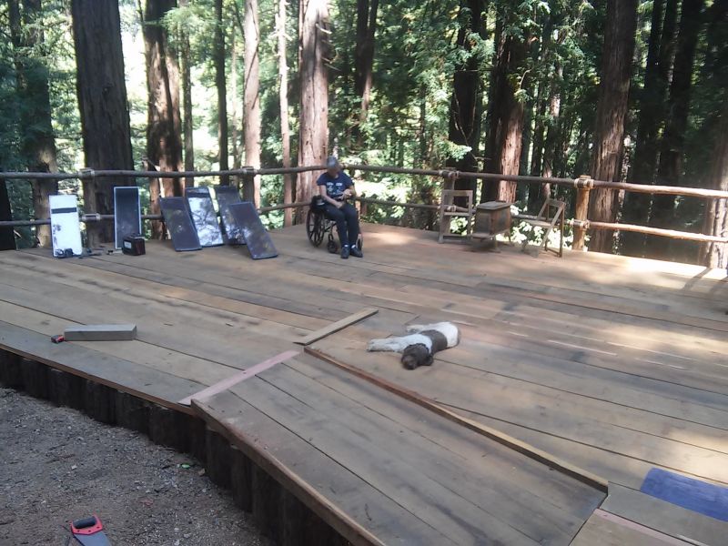

# Posted: 25 Nov 2021 10:11pm - Edited by: paulz

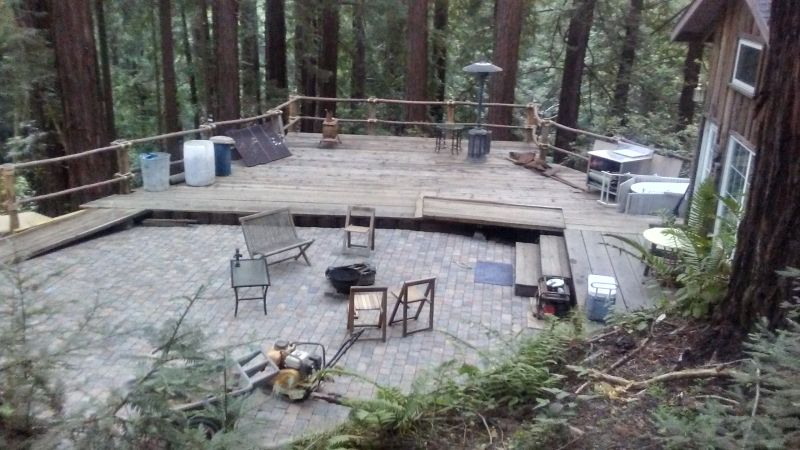

Mine are rustic, and redwood of course..
# Posted: 25 Nov 2021 10:16pm

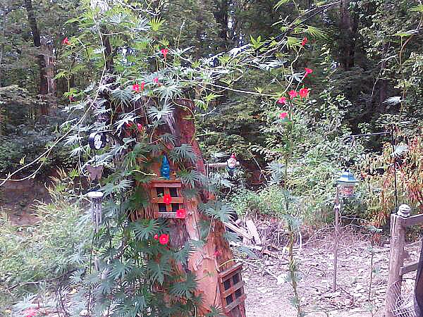

Here's a couple pics of the cardinal vine when they took over the grandkids gnome tree. The pic shows when they first started bloom. When they really get going. There are hundreds of red flowers.....hundreds.
This year we got some sweet potato vines and a couple others. One was called the ace of spades, another was called something or other that had dark leaves and some pink to purple color in the middle of the leaf.
# Posted: 25 Nov 2021 10:25pm
Dammit Paulz.
I post a gnome tree. And you post an a amphitheater! 👅👍

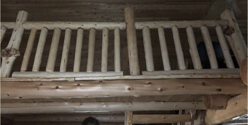

New railings on our loft catwalk. Husband built with trees from our property.

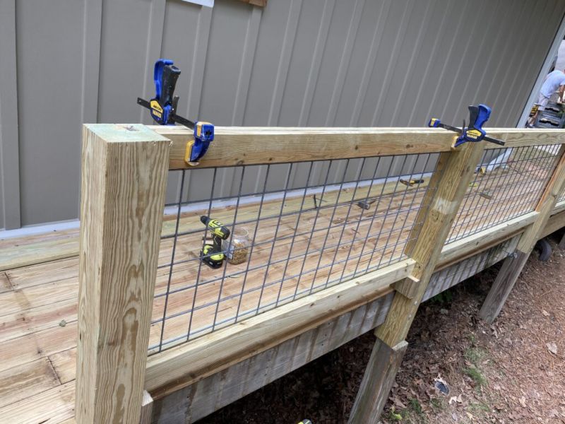

Nice! Looks tropical, we are wondering if we can even get grass to grow! Dug out in front of the cabin and used the overburden to build a side yard.... the ground is pretty sterile. A friend with a farm is going to bring us a couple of loads of rotted cow manure mixed with river silt so that will help. I like the twigs tied to the wire idea! The 4" goat panels are effective and to code but pretty industrial looking.
Paulz... We are over 3' off the ground so going to try to bring it to code meaning, basically so no little kids can fall off! Your's looks great though!
Here is what we're thinking but.... not 100% liking it.

# Posted: 26 Nov 2021 01:23pm
Wire panels like that usually fail code because the horizontal bars easily allow little hands and feet to climb it.

I have +80' of railing to build so it will all match. Copper would be sweet but costly... rebar would work as long as it didn't look too industrial as well. Thanks for ideas!
ICC... our local inspector is fine with the goat panels, 4" squares with no more than a 4" gap under the bottom board. Indeed it can be climbed...
# Posted: 26 Nov 2021 05:32pm
Quoting: Nobadays
Yeah, inspectors can exercise the option to "not see" something and let it pass an inspection. Passing inspection with something like that in place does not mean that the project detail is to code though. That is why I point at things like that. The inspector here would likely not tag that here on a remote cabin but might not let it slide by in a more developed area. He's been in the job since the mid-'80s and it has been an interesting education studying his red tags over time and from project to project.

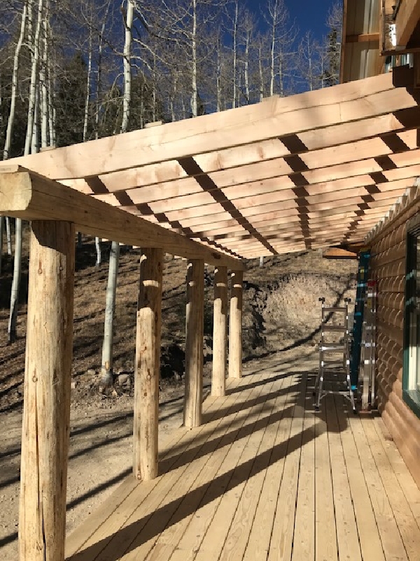

# Posted: 4 Dec 2021 08:15am

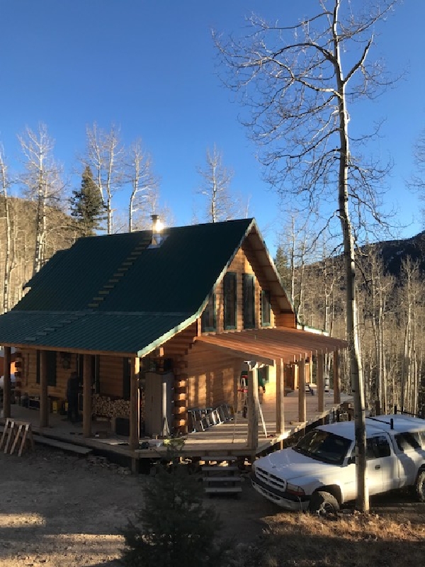

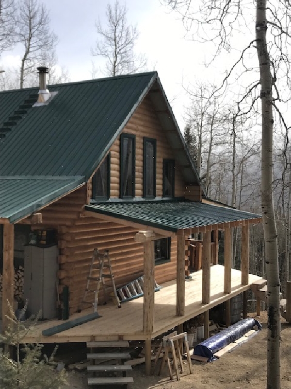

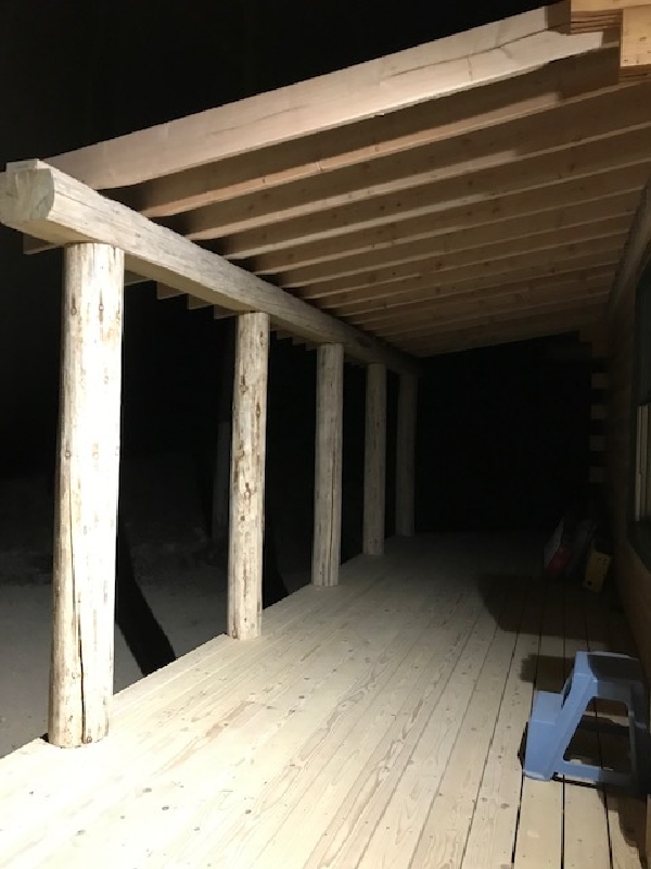

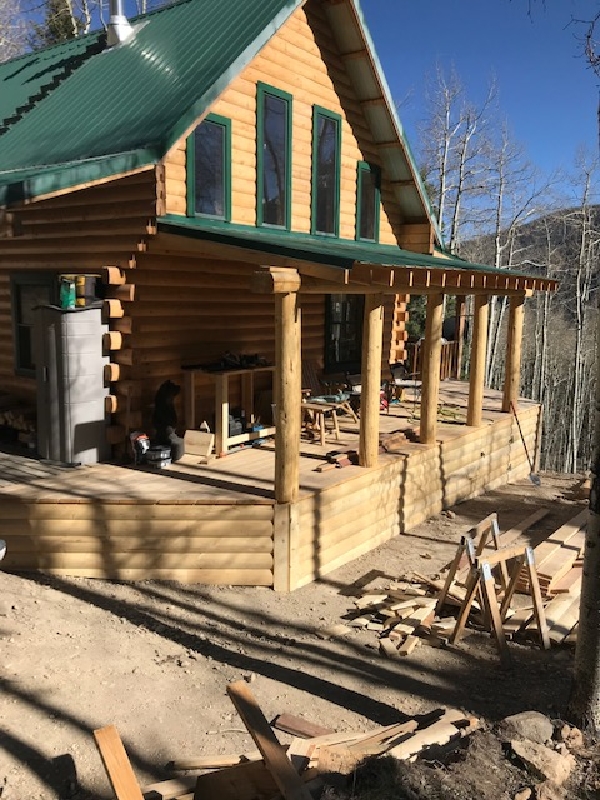

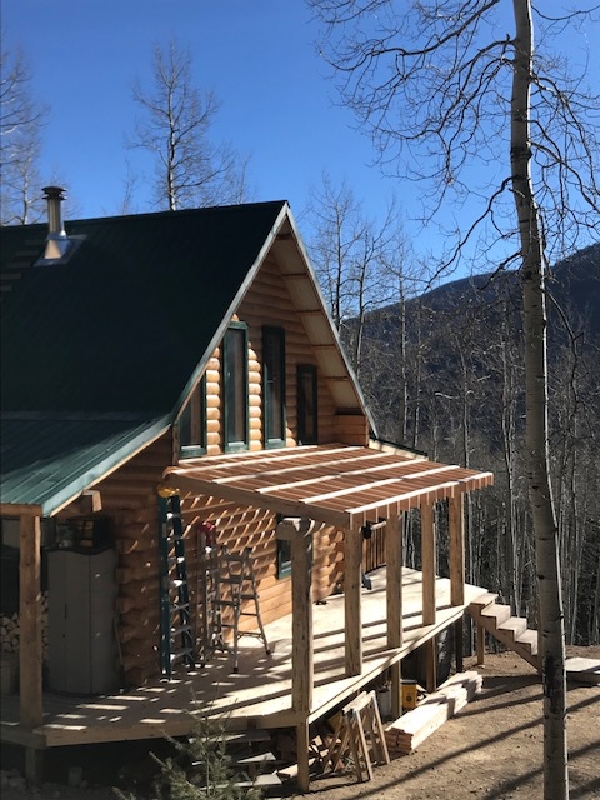

Three days hard work peeling logs, 2 siding 12' logs, standing the uprights, then the getting those 2 sided log beams in place (a 6'7" friend was a big help!) And then the rafters cut and placed.... whew! Still need to finish nailing off the hangers and hurricane clips on the outboard ends. I'll get the skip sheeting up today the I have to wait for the metal... it's ordered but won't get it until next Thursday.
The bad news.... snow Monday night/Tuesday, likely not much.... then again sometime between next Thursday and Saturday and forecast to be a good dump. They're say clear after that for nearly a week. Just got to get one good dry day.... and dry feet, and we can get the roof on. Fingers crossed!
# Posted: 4 Dec 2021 08:29am - Edited by: paulz
Nice! How are the posts attached to the deck?
# Posted: 4 Dec 2021 09:23am
Thanks!
A tenon in the bottom to eliminate lateral movement then 4 x 10" timber lock screws that go through the deck boards into the double 2x6 rim joist.
# Posted: 6 Dec 2021 01:48pm - Edited by: Nobadays
Supposed to be a bit of snow tonight, a skiff, then start snowing in earnest Thursday afternoon and Friday. They are talking 10" - 20" .... So called the metal company this morning and pleaded with them to get my metal rolled quickly so I can get it up before it snows. They were really understanding and said they would rush it through and I can pick it up tomorrow afternoon! Got two friends coming Wednesday to help us get it installed.
# Posted: 8 Dec 2021 04:15pm - Edited by: Nobadays
My wife and I got back from town with the metal about 1:30 yesterday (Tuesday) and decided to see if the 2 of us could at least get it started, squared up and ready to finish when help arrived Wednesday. We'll, by 4:30 it was all up and screwed down! I was unsure if my wife could hand the 10' sheets up by herself.... she handled it like a boss! Shee shoved them up the ladder and I grabbed them and pulled them up. We finished the trim this morning just as the first snowflakes started to fall.... wind had kicked up and it was getting really cold. Glad to be done and off the roof! Snow is coming down now!

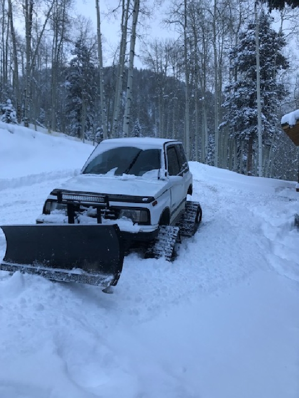

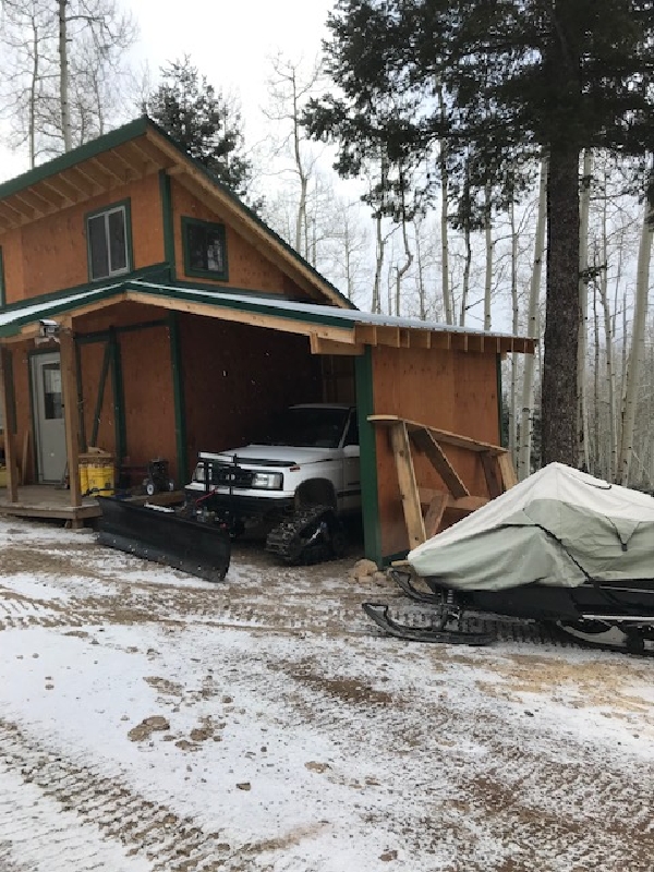

Thanks gcrank1! Ate lunch then went back out and put the snowplow on the Tracker.... moved the snowmobile out of the lean-to and backed the Tracker into its winter abode!

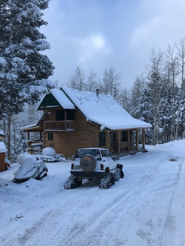

# Posted: 10 Dec 2021 11:57am

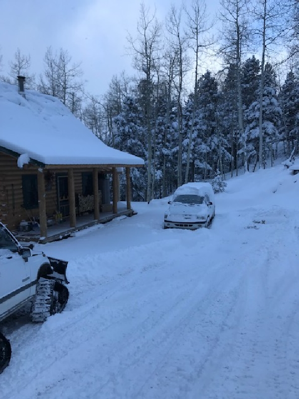

Got the deck finished just in time! Got a full 12" of snow overnight and it's still trying to add a few more... supposed to clear off later in the day and get cold tonight. Forecast is -9/-15F brrr!
# Posted: 10 Dec 2021 12:33pm
Before
Now
The origins of the term 'bi-polar'?

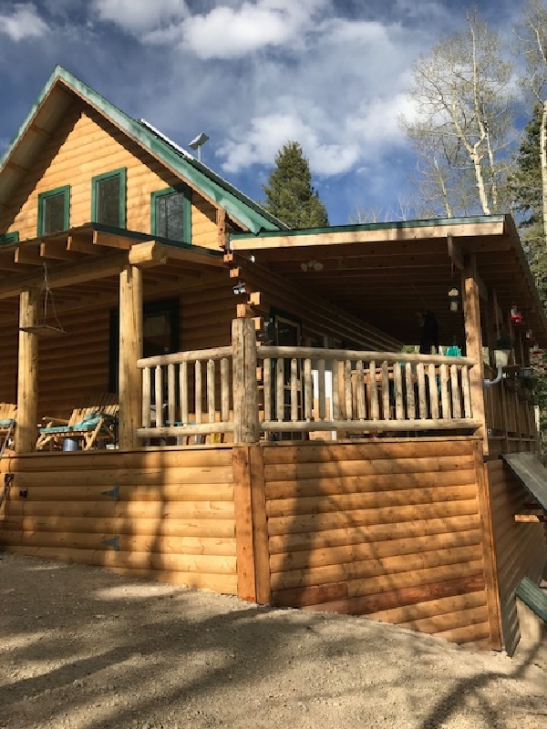

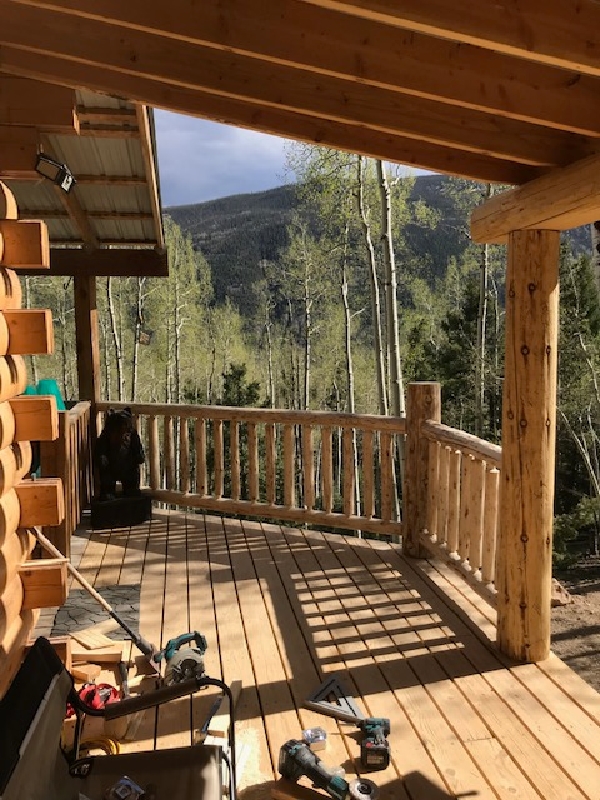

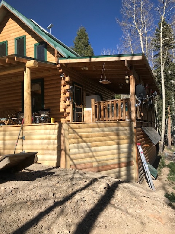

# Posted: 16 May 2022 07:24pm
Back to work finishing the new west side deck. Got the log siding up and stained last week. Now we are building log railings. Sure seemed a lot easier in my 20's - 30's when I was building log homes....
# Posted: 16 May 2022 07:30pm
Got the really dangerous end railings up first. Neighbors have two boys that are "all boy" they scared me last fall when they had to go peer over the edge....
