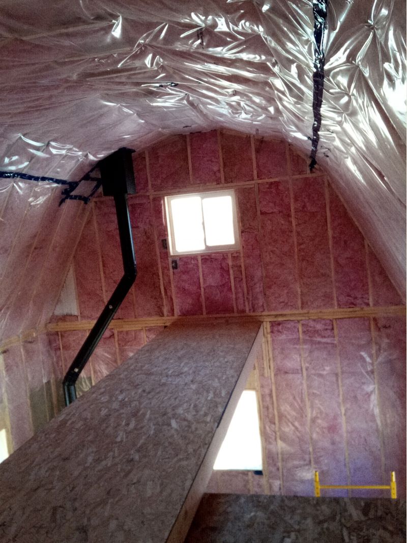

Well, I have been away from the cabin for a while as my son asked if I could possibly build him a bedroom in the basement. So that has been my priority for the last few weeks.

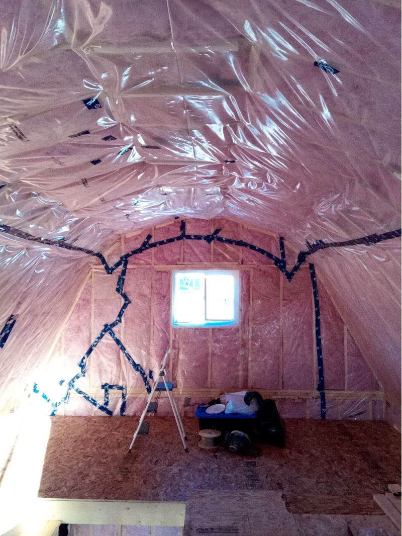

However, I got a chance to go out this weekend and bring the cabin a little further along. Almost got all the vapour barrier up (sigh short 10ft of poly). I was shocked at the difference 6mm of poly made. It was toasty in there and last night was -25C.
Unfortunately I'm running out of jobs that can be completed over a weekend in the cold. After I finish the insulated floor, I'm not sure what else to do. Most everything requires multiple days of "curing" time where things must be kept warm. I guess maybe start hanging drywall. However getting materials in is starting to be an issue with the snow.

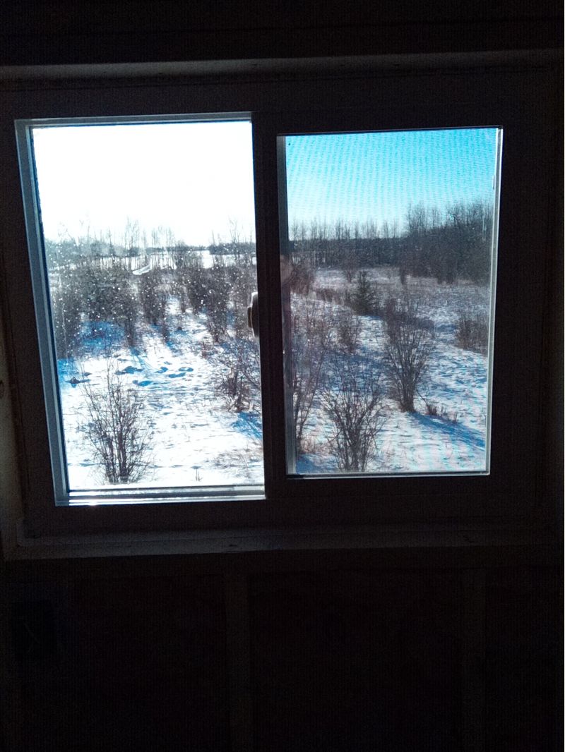

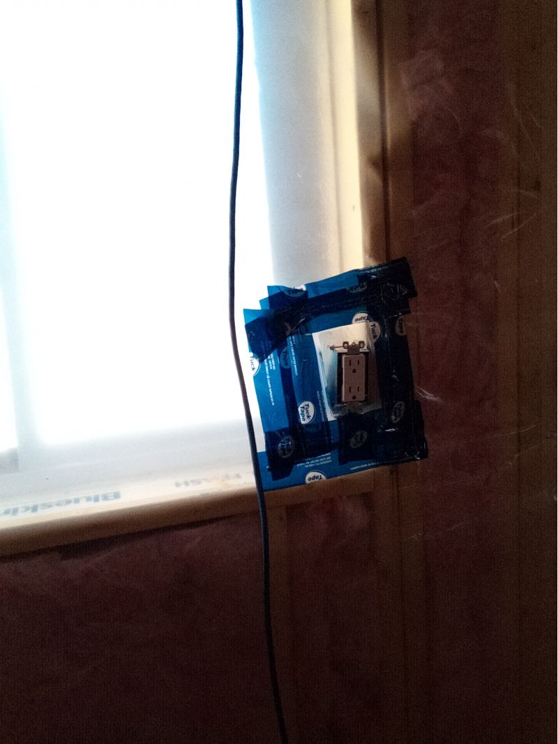

A few more. The one is our solution for getting temporary power in from the generator. It was shocking how much air that window was leaking with only a small opening.

Coming together....nice!
# Posted: 5 Dec 2021 08:19pm
Looking great traveller. With a wood stove I bet you could slap 2 coats of mud on the walls in a single day. Granted you would prob wear out before one coat is done on a structure that size. Wood stoves make things dry really fast. I would hesitate to put drywall up and do the first rough coat in the bad areas. The bad areas usualy crack again. Before ther fully dry anyway.

# Posted: 6 Dec 2021 10:21am
Looks good. Are you going to drywall the ceiling? Looks like it would be a tough job. I was going to do mine (15' max height) but went with cedar t&g.

# Posted: 6 Dec 2021 11:14am
Looks great! Are you keeping that catwalk?
Any pictures of what you did for your rafter framing before you added the insulation? Looks like you added some additional members to give some structure where the plates are at the rafter joints.
I'm %90 sure I will drywall the ceiling. However I will use 16ft sheets so I only have 1 butt joint to mud. With 3 people and the scaffold, it shouldn't be too hard. The long horizontal joints will be covered with battons (caulked and painted the same color as the ceiling). That way I don't have to try and mud/tape that strange angle and keep it dead straight.
Its funny you aren't the first person to ask, but no the catwalk is just temporary so I could work without the scaffold (a little sketchy using a ladder on scaffold).
As to blocking, we added 2x4 blocking near the ridge. We alternated, one to the right of the plate, one to the left for the length of the building. We also added 2x2 inset between the plates to flatten each of those runs once we add drywall. We used a 6ft straight edge, but I'm still not super happy. I suspect I will be using a whole lotta shims when installing the drywall.
