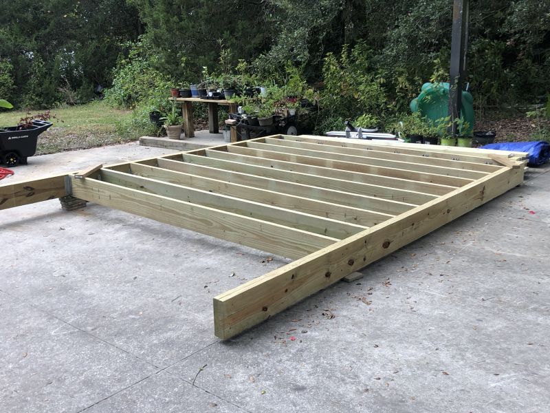

My contractor friends think I'm nuts....maybe I am. I am constructing a 12x12 cabin in my driveway in Florida. I plan to disassemble it, carry it on my trailer and reassemble it in our mountain property in North Carolina. Just the frame mind you. The exterior, interior and roof will be finished on site.
Why would I do this. (1) I spend 85% of my time at my home in Florida. Being retired I "need a job". Or at least my wife says I do. (2) This gives me an opportunity to work out all the bugs so that when I arrive on site its an assembly process. (3) The cabin site is several hundred yards up a steep ATV trail at the top of a knoll. The less equipment I have to haul up there the better. I have a plan to use my tractor to haul the lumber up to the site. (4) I have son-in-laws local to me to help raise the timbers.

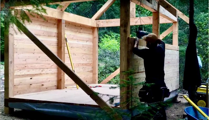

Our inspiration is a cabin built by a guy in Oregon who is in the building trades. It is post and beam construction with 1 1/2" tongue and groove siding, floors, walls and ceiling along with a metal roof.
I don't plan to insulate as it will be a fair weather, occasional use cabin and not having wall cavities for vermin to nest in is a top priority.
The posts and beams will be 6x6 pine. He uses some larger timbers.
Here is the link to his build.
https://youtu.be/0YDj6n2f4ow
It gets down to the teens where he lives in Oregon and his small wood stove keeps his tiny cabin toasty warm.
Floor framing
Floor framing
YouTube inspiration
YouTube inspiration

I would cut all framing and lay it out on the flat driveway but not fasten together unless you are planning to haul a complete wall, floor or roof section. I would label the lumber so it would be easy to put every piece in the right place. I don't like the idea of running a screw in, then taking it out and finally screwing it together again.
