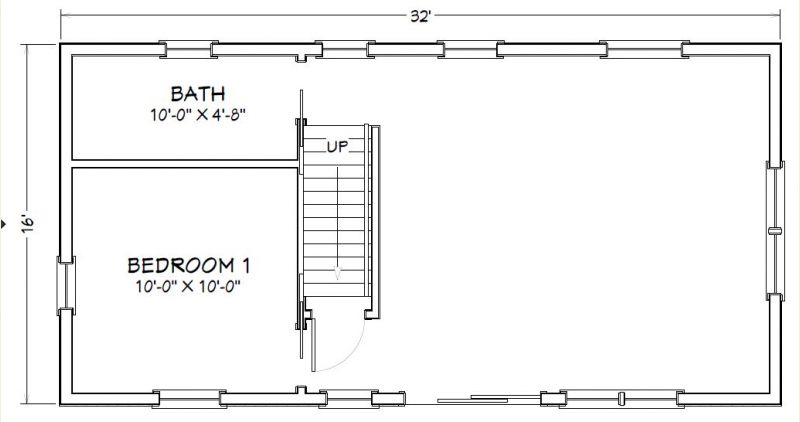

If I remember right your did a gambrel roof. I'm doing the same and I found that putting the stairs up the exterior wall with a landing then up to the center of the building kept the most heat room in the loft. Like so..

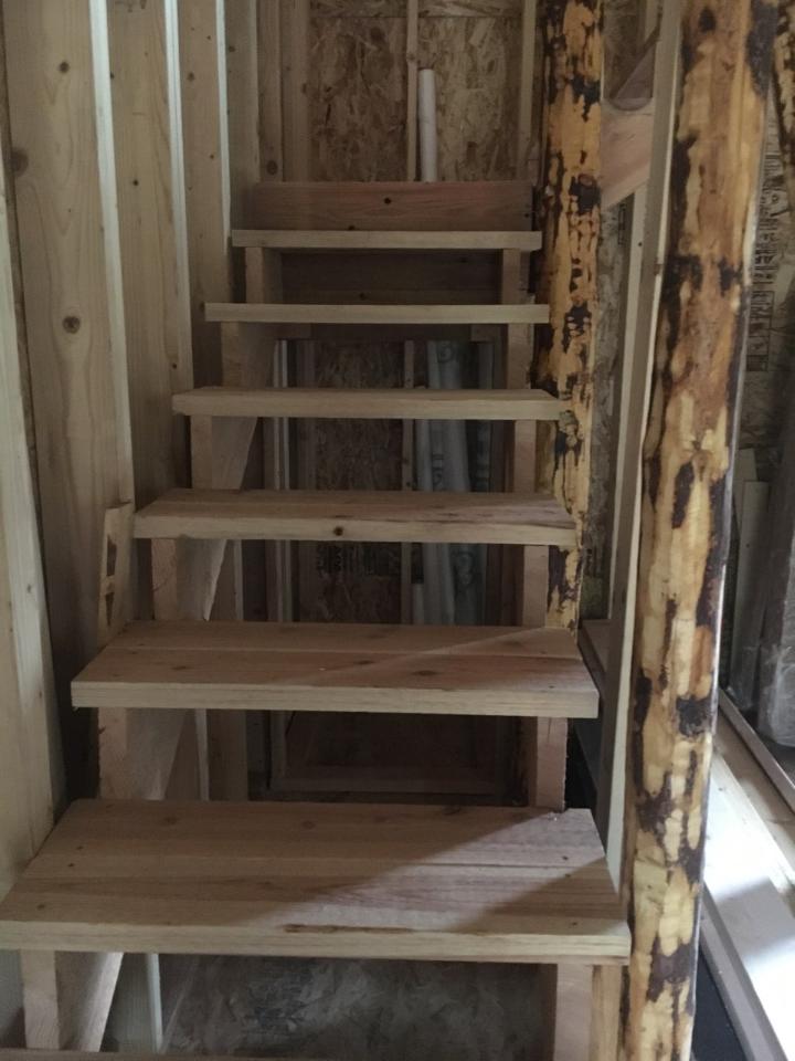

I built some 36" wide deck stairs using 2x12 stringers on the ends of the steps and 2x12 steps. I used the table saw to cut grooves about halfway through the thickness of the stringers and then set the steps into the grooves, put three deck screws into each end of every step (through the stringers). No risers, as it's a deck stair, but you could easily put risers in. No noticeable deflection of the steps as is.
Just another way to do it FYI.

For my cabin, I wanted to use the gable end walls to my advantage and to minimize the amount of loft space lost. I started the stairs on the eve wall, then transitioned up the gable wall the last 4 steps. I built a landing in the corner and put steps down and up from there.
I used Doug fir 2x12 and only used two. Then I used 2x cedar for the treads. I made it ergonomical for my dad to get up and down. It really takes up minimal space.

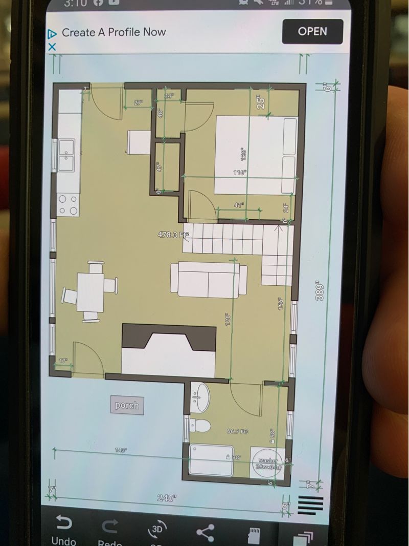

Yeah, this whole stairs thing has been a weird one. When i designed my place (photo below), i missed the part of the code where i had to maintain a 6'4" clearance for 36" at the top of the stairs. I thought it was only vertical from the nose of the last step. So plan B was to put the stairs perpendicular to the wall next to the bathroom door. But following code, this causes the stairs to jet out quite a ways into the living area.
So i've been emailing back and forth with the BI to see what options i had as a spiral stairs wasn't really going to save me any square footage. I asked if i could use the max riser height of a spiral stair case which was 9.5" vs. 8" for straight stairs. I also asked if i could use the minimum width of a spiral staircase but for a straight one which would allow me to have a 5" narrower set of stairs. She emailed the state and they said no and not to waste there time with asking/applying for a variance. She said the state is very stringent on staircases because of all the lawsuits around them.
But here is the best part, they said that if I can't comply to the staircase guidelines that i should build a ladder and follow those guidelines as that's my only other option......WHAT?!?!?! Your worried about lawsuits and you'd rather me build a steep ladder vs. a straight set of stairs that follow spiral staircase specs vs. the straight ones?!
So her answer to my problem is to follow the code for stairs, or build a ladder, and as she said, she can't control what i do with that ladder after final inspection
