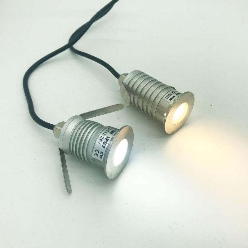

I picked up a couple packs of these 1w downlights. Wondering if anyone else has used these. Hoping to put them in next summer.
My plan is to get them up around the ceiling or possibly loft over counter space etc. I plugged one into an old motorcycle battery and was pleasantly surprised with the amount of light they throw.
I think I am just going to start off with an old car or moto 12v battery and either charge it periodically or run a trickle solar panel. Im only up there so often for a night or two. Probably a dozen of these and maybe a usb charger for the cell phone.

I used some similar lights in the past. The only difference was mine were gimbals and could be pointed.
While they do throw good light for a low amount of power, I didn't get a great life out of them. They died in under 2 years of use (about 20 min nightly). Might not be a problem in a cabin you don't use often.
Mine drew about 0.09A @ 12V.. So you could have 10 of them running and still only draw about an amp.

Cool. They were definitely some cheapos I bought so I will make sure to leave easy access to the wire runs in case I need to swap out a unit. Being able to focus them sounds cool. Maybe I will take a look out there to see what other options I can find.
