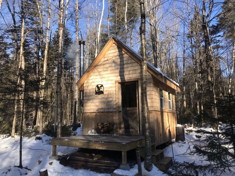

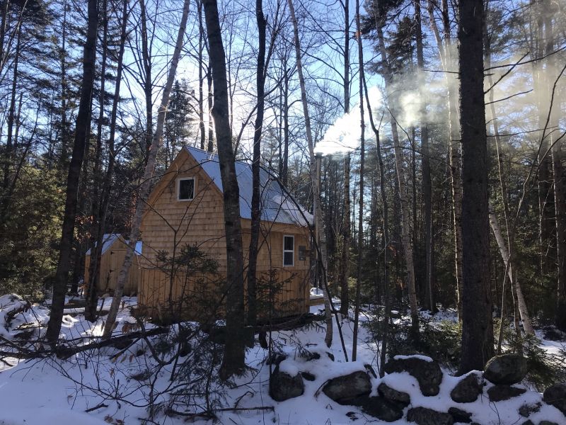

10x12 w/loft My wife, two children and a dog! I will say this spring there will be an 8x10 addition happening... Remember, even a tiny cabin is better than no cabin. Good luck with your build.
Taken 01.04.22
Taken 01.04.22
Also taken 01.04.22
Also taken 01.04.22
