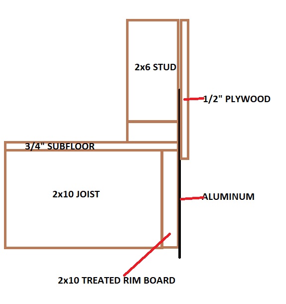

I don't quite understand what the picture is showing,
curious
# Posted: 4 Jan 2022 09:25am
Oh, is the plywood on the exterior overlapping the sheet metal band and the plywood is nailed to the bottom plate and studs?

I don't think the problem is the air can get to it through the crack, the whole piece of flashing is just much colder than the inside air temp. Even if you caulked it, this would still happen.
If you're heating with something like a buddy heater that puts out a lot of moisture the problem is just compounding...what you're seeing is the cold beer can effect backwards. Hot outside, cold inside, metal surfaces condenses moisture in the air.
That being said I don't think you have this problem anymore once you have insulation and a vapor barrier, assuming that you have something inside exchanging the air faster than it can seep through the cracks in the walls. The flashing will still be cold but the vapor barrier should stop the majority of the moisture from getting that far.
Meaning if you have forced air, or a vented stove of some type you'll be pushing out the warm moist air out through that faster than it can find its way out through a wall.
I think I'd caulk the gap anyway and then not worry about it. Don't insulate until its warmer outside and you are sure the moisture is gone so you don't trap it behind the wall.

So the photo is from inside of the cabin.
Yes, the plywood is nailed over the aluminum. I added an illustration to show a cross section of what you are looking at.
The sheathing covers all of the studs and maybe about 1" of the rim board. The aluminum Hangs about 1" below the rim board and covers all of the rim board, all of the bottom plate and ends about 2" above the bottom plate....which is what you see in the photo above with the frost on it.

The aluminum is a heat sink and will always attract any moisture when there is a temp differential. Even when you have insulation in place, it will pull whatever it can from it. Spray foam "may" cancel that out due to the direct contact & adhesion but I don't know.
You mentioned Pressure Treated & Aluminum, I really hope that the metal is completely isolated from PT wood or nasty things will start in short order. Makes a mess out of aluminum in a couple of years.

If you do full vapour barrier, then I don’t think this will be an issue. The vapour barrier will stop the warm moist air from entering the wall cavity. I would pay close attention to sealing up any outlets though to ensure no leakage.
# Posted: 4 Jan 2022 11:59am
The reason why you see this is because you heated the place. Warm moist air is hitting a cold metal object. Same as a glass of cold water on a hot summer day.

This. The aluminum is cold and non-porous. There is moisture in the heated indoor air from your body, cooking, doing dishes, and anything else involving water. That moisture is condensing on the aluminum and then freezing.
I wouldn't worry about it if it is short term (couple of months of cold weather). When the time comes to insulate and install the vapor barrier, do a good job on both and your cabin will be fine.

I am no expert, but I think this problem goes away when you insulate and vapor barrier properly.
Right now you have warm moist warm hitting a cold wall. That temp differential goes down substantially once you insulate, and the moisture differential will go down to nearly zero once you put up the VB.
You will then only have the differential between the outside of the plywood and the house side of the plywood which is minimal.
I think what you're seeing is just an effect of building in progress.
