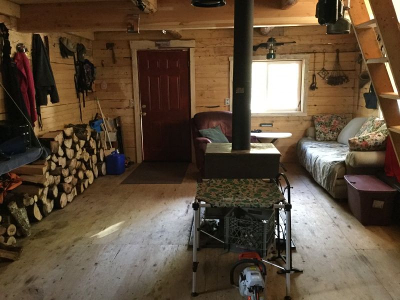

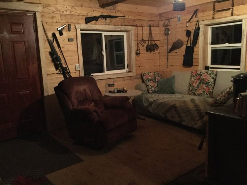

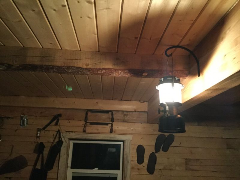

Been a while since I've done much woodworking n putting a finish on wood. My perfect topcoat would be a water based low oder fast drying laquer. I thought I have a gallon of deft brand at the cabin but can't seem to find anything anywhere now. I need to put a finish on 186 1x6x8' TnG pine for finishing out the upstairs ceiling. I would like to get a finish on it before I install it. Get a good coat on the back also to seal it. Going to do a couple coats. Also want to sand the walls down enough to smooth them out some. A lot of sanding n putting a finish on. The entire interior. So saving labor is important. And I need a water based product to control the odors. I see the acrylic stuff but not real familiar them. Deft brand petroleum based laquer and varathanes I know. So any professional have painters or folks who have applied a topcoat to the inside of a log cabin or pine TnG ceilings, any suggestions ? Thanks all, appreciate the support Upstairs

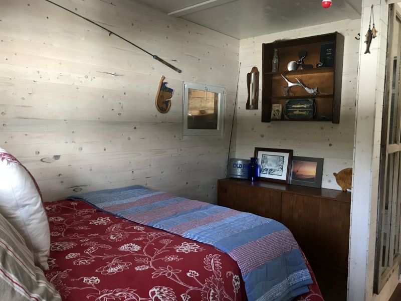

# Posted: 9 Jan 2022 02:35pm
as much as I like wood, we went (against my preference) with a white wash (just thinned out white latex paint put on and wiped off with a rag).
Once finished I'm glad Mrs Fishie went against my wishes as it really brightened up the place. Was fast and easy to do and easy to clean. Touch ups are simple.
If you want to avoid that dark interior look of lots of wood, I'd recommend it.

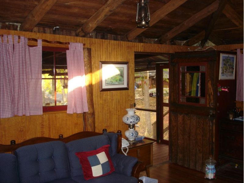

In our cabin community a lot of the cabins were "updated" during the 1950s and 60s when people painted light colors over the beautiful chestnut beams and ceilings... you can't unpaint it. Well, maybe a little... in our cabin the ceiling/roof (native American chestnut cut on site during the 1920s) was fortunately untouched, but I had to scrape white paint off some of the vertical log posts.
