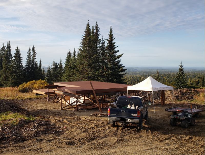

I am having trouble finding concensus on when, and exactly how to deal with with wall strapping. I am building my cabin on piers and beams, not a "traditional” block foundation like most residential homes. I am wondering if I need to actually install wall strapping.

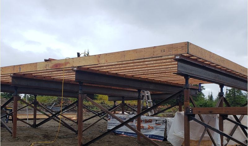

For my particular build, the joists cantilever the beams about about a foot on the ends, but are flush with the beams on the sides (I will try to find some photos to demonstrate this.)
The plan currently is to lap the entirety of my rimboard with my wall sheathing, which would give 9.5 inches of coverage. This will tie my walls into the rimboard quite well imo. I am wondering if I need to go further and use strapping to connect the wall studs to either the rimboard (seems redundant) or the support beams themselves (seems overkill, and hard to accomplish on cantilevered ends). Current connection consists of toenails on each side of each joist and blocking, at each beam support.
The area is known to get occasional high winds (NYE weekend had 60MPH gusts) and I am semi exposed on a hillside. Additionally the base of my floor is 5-7ft above grade (to compensate for snow and the ability to park ATVS, etc underneath). This area is outside of building code jurisdiction, so I have no inspection to pass, but also no BI to consult. Just looking to do whatever is prudent, it doesn't need to be apocalypse-proof.

The sheathing over the rim joists is great. That provides an excellent connection between the wall structure and the floor assembly. Adds a lot of lateral strength.
I/we have used H-1 and H2.5 hurricane ties to connect floor joists to the beams when the joists are sitting on top of a beam. They provide very good uplift resistance and may be installed using approved screws or traditional framing nails.
The ties also provide some lateral resistance however blocking between floor joists over every beam connection improves that a great amount. If the floor joists are more than 6 times their thickness blocking called for by the IRC. Blocking also transfers loads between joists making the entire floor assembly more rigid.

I did not notice there were I-joists. Usually the I-joist manufacturer will list all the necessary details for installation. Many times I-joists will not call for them, but wind and seismic loads can affect what is best.
It is an engineered product so the mfg should specify does and don'ts.
If blocking was needed or wanted you can usually sub strapping that is nailed to the joists in an X pattern, weaving over and under the joists before the subfloor is installed.
