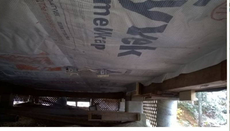

Hey guys, just brain storming and planning for spring. My cabin is on piers ranging from 2-4ft off the ground. The ground is all bedrock so minimal moisture. I plan on putting batt insulation between the floor joists. Now to protect it from mice, insects, and moisture. Other camps in the area have just put 7/16” osb. Will that hold up? Spend a bit more and put 3/8” plywood? Mice can chew through wood. I was thinking house wrap and 1/4” wire mesh.
https://www.homedepot.ca/product/fencer-wire-1-4-inch-x-4-ft-x-100-ft-23-gauge-hardwa re-cloth/1001469451

I have thought of these same issues.. Mice are persistent and will find any little hole, then leave a pee trail so other mice can follow. In the end I came to the conclusion that the only %100 solution was to keep the insulation on the inside.
Mine will be insulated with 2" foam on the inside, then a 5/8" subfloor over that. However thats usually not an option unless you planned for it during the build.
I think a better solution if you didn't plan for an insulation subfloor, is rigid foam between the floor joists. Its way more work, but mice seem to like it less. It doesn't make a nice warm cavern full of nesting material!

That's exactly what we used. We have had no critter issues.
TSC (now Peavy) puts that 1/4" mesh on sale regularly for a significant discount. Keep an eye out if you have the time.

I'm building a small cabin on a trailer this winter, I'm going with fiberglass insulation with 1/4 inch hardware cloth, all the research I did said that should keep mice and squirrels out. They will just eventually chew through any kind of wood given enough time. I hope it works, I got some from Peavey Mart a week ago on sale.

Bingo, and a nice little air powered crown stapler can be used to secure it to the rim joist so they dont try to enter under the ends, and if they try, metal flashing, just a flat roll of the stuff and secure it with the same crown stapler.
I used a full footing/stemwall with no exterior crawlspace access, my vents have the same sized screen mesh. No varmints.... well, not a woodpecker, but I think I took car of him and didnt even have to kill it.

I sandwiched Reflectix (bubble foil) between the joists and plywood decking when I built my 10x16 bunkie.
I've seen it done with success from a few youtube channels I follow. You can also add it in the joist cavities after the decking is down if you can access it. Make sure it wraps down the joists by a few inches and tape the joints with foil tape. Chipmunks and other critters don't like the foil and don't seem to chew through it. Doesn't give much R value but I did alright in there with a heater and rockwool in the 2x4 walls at -30*C

Do always keep in mind the moisture & humidity under the cabin, bedrock exposed or not. If you intend to put any OSB or whatever up to enclose the floor base, do pre-treat it & prep it properly before insalling it. After a few short years OSB will start to swell & separate and Ply can start to delaminate... A Can of treatment is cheap and smart thinking.
Piers.
That is the access path for rodents, you can put aluminum shields around the Posts and even a Guard Cap to prevent rodents from climbing up the posts such as this below. Making it harder for them to climb up to the structure is not that hard.
Rat Guard Shield
Insulation Process, just my thoughts.
- Install Building Wrap onto the joists, then the Treated sheathing material. Make sure everything is sealed, especially around any pipes etc.
- Use a "Spray Foam Kit" (Non Soya !) and spray in 1 inch, making sure to get all the nooks and everything is sealed.
- Then use Roxul Batt to complete the insulation fill between the Joists.
- Next lay down a heavy 6mil+ plastic, sealing it to the joists with "Acousti-Seal", and then lay your subfloor.
https://www.lepage.ca/en/lepage-products/build-things/sealant/pl-construction-sealant /pl_acousti-seal_vapourbarriersoundreductionadhesive.html
You have not mentioned how the plumbing etc is being done, if through floor or out a side wall or what. This can sometimes be a "critter highway" as well. The chipmunks up here got Damned Creative ! Never underestimate motivated beasts !, Aluminum shields & guard do work a treat around any plumbing access points. The little bugger only need one "TINY" spot where they can start to gnaw a hole.
I watched field mice squeeze through a 3/8" Hole with little difficulty! Chipmunks can get through a 1/2 hole...., ruddy blighters, a MENACE !
