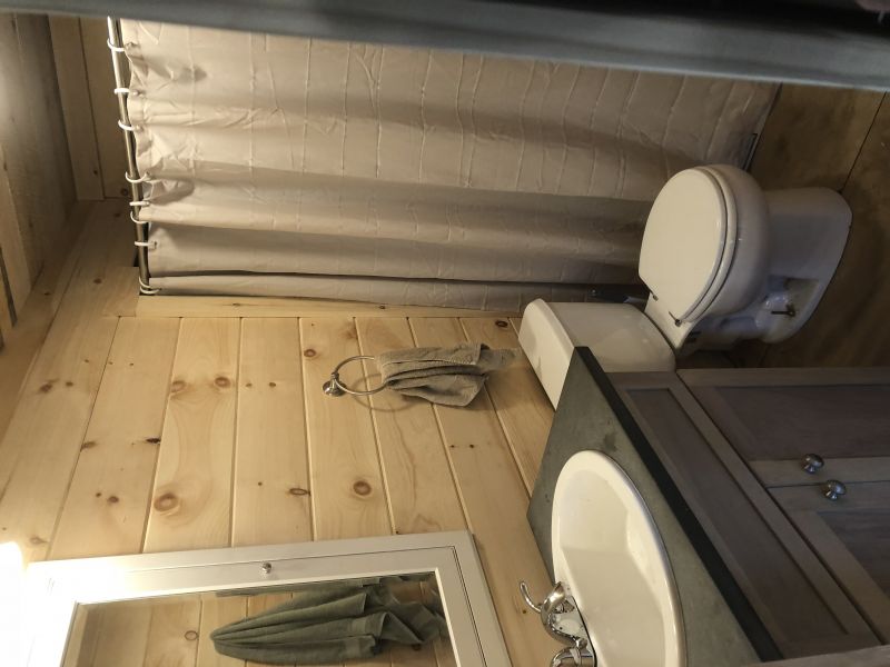

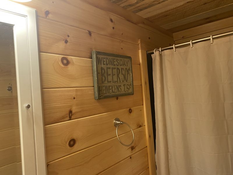

I have some in my cabin bathroom that I didnt put any finish on and it hasn’t changed much. It doesn’t see much natural light though. I also have pine doors that aren’t finished and get looks of natural light and they haven’t darkened much. You can see in the first bath pic was when it was installed and the second was last week, about three years
