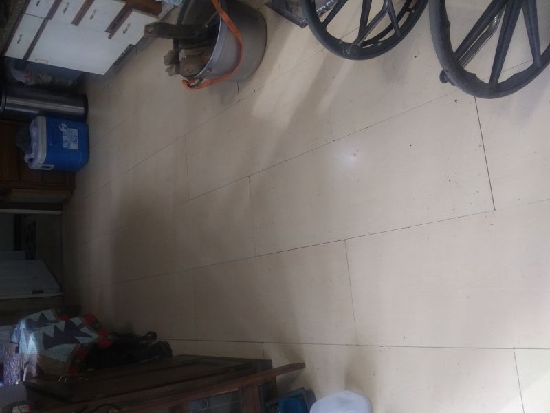

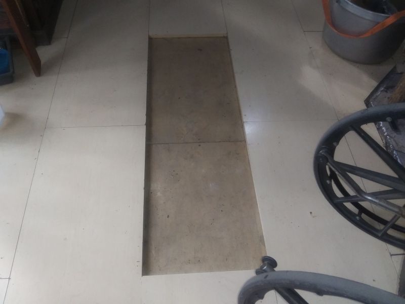

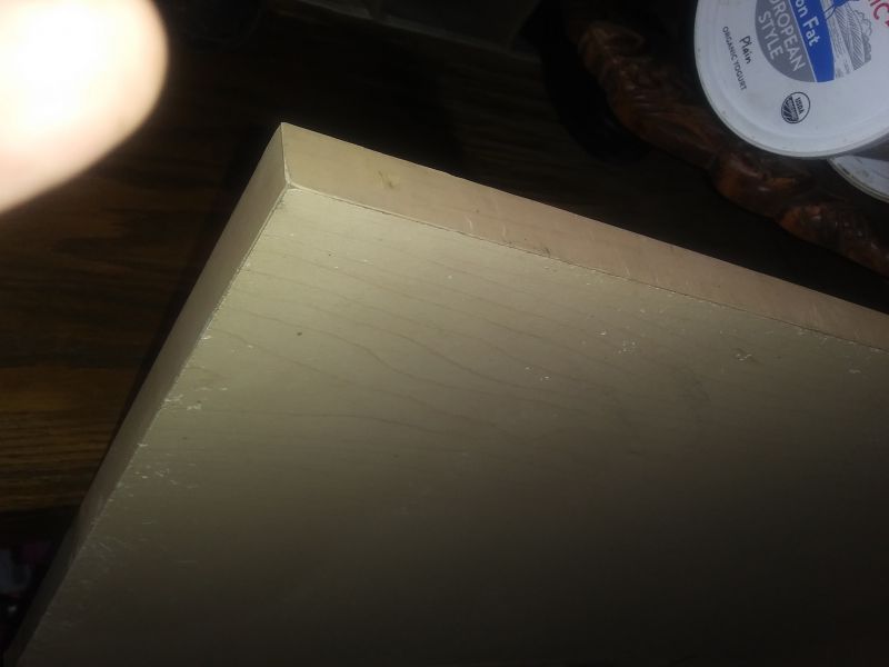

# Posted: 20 Feb 2022 12:33pm - Edited by: paulz
OK you've seen the best, now here's the rest, lol. As most of you know my cabin is mostly recycled materials. About the time we were walking (and rolling) on plywood, a friend called to say a local store was closing and giving away a bunch of shelving..
Surprisingly, they have been in 5+ years, and aside from a couple of ember burns, look as good as new. No scratches, they have a very hard surface and particle board center, heavy. Couple of good things, they are just laying in place, easy to replace one with the 200 spares I have. And the light color helps brighten the place. I'm not a big indoor decor guy, prefer the outdoors, much to my wife's dismay.
I have nice new oak T&G flooring I took out of that same friend's daughter's newly built tract home because they wanted carpet. Some day I'll probably put it in, why I'm not sure.
