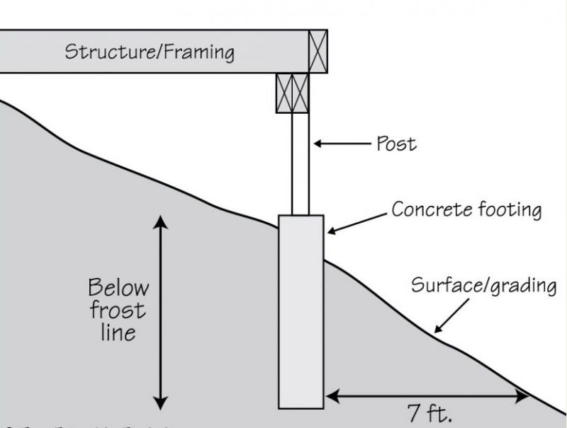

What is the soil on the slope like? Can you tell how stable it is? Does it contain much clay?
What type of piers and footings are you thinking of?
There is a very general "7 foot rule" for piers on a slope. The image explains it best, but the bottom of the footing should be placed far enough back into the slope to be 7 feet back into the hill. But id the soil is not stable then an engineered solution may be best.
slope
slope
