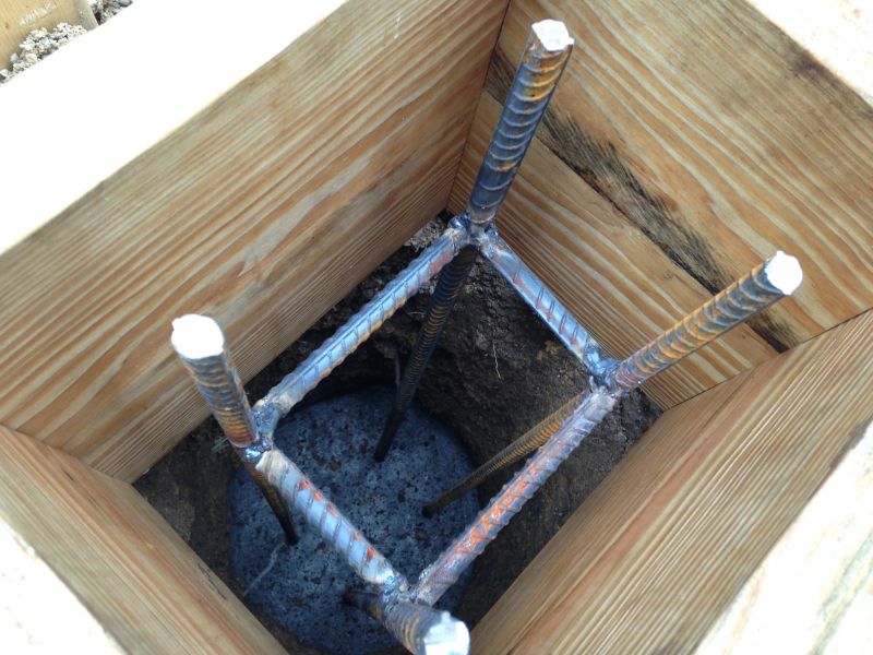

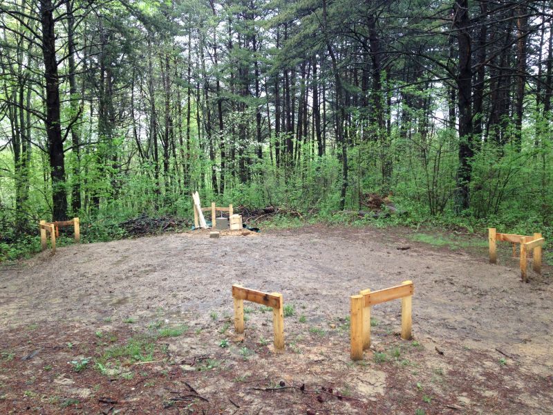

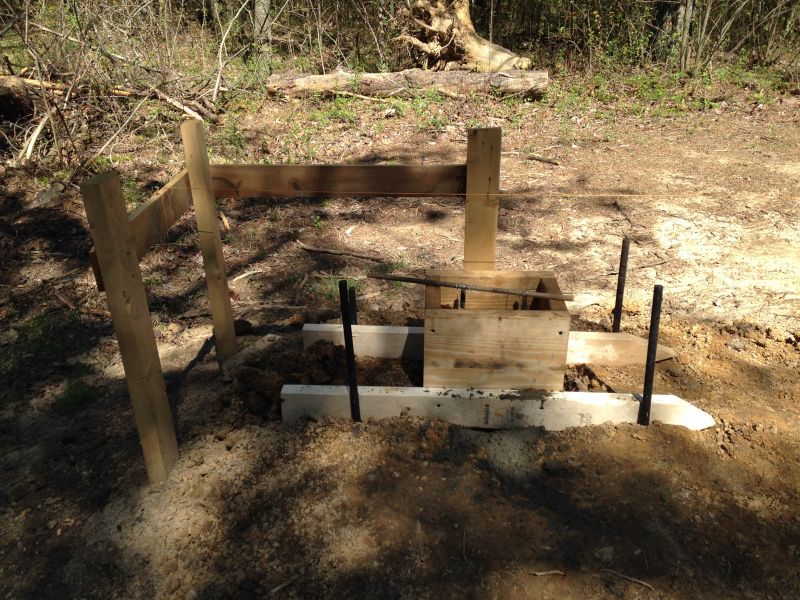

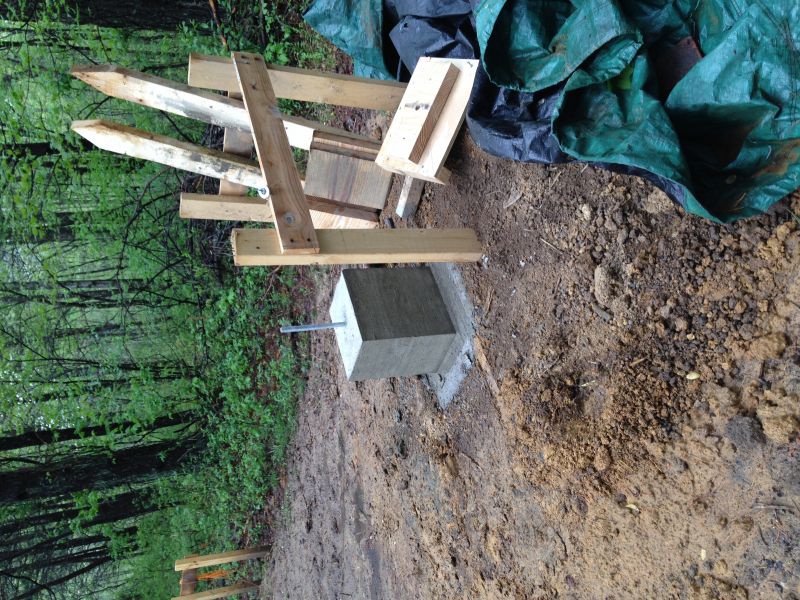

Nothing to worry about if you use concrete, as you know. Here are pics of how I did it. There are
numerous options. I liked it to look good and
easy to skirt, so it's formed up rectangular above
ground. It's not going to blow off the foundation
since it's well fastened with L-bolts.
Another option is to use Perma-columns, if you can
get them on site. They are heavy. The barn built at my place was built using them, instead of poles in the ground.
It's better resale value down the road.

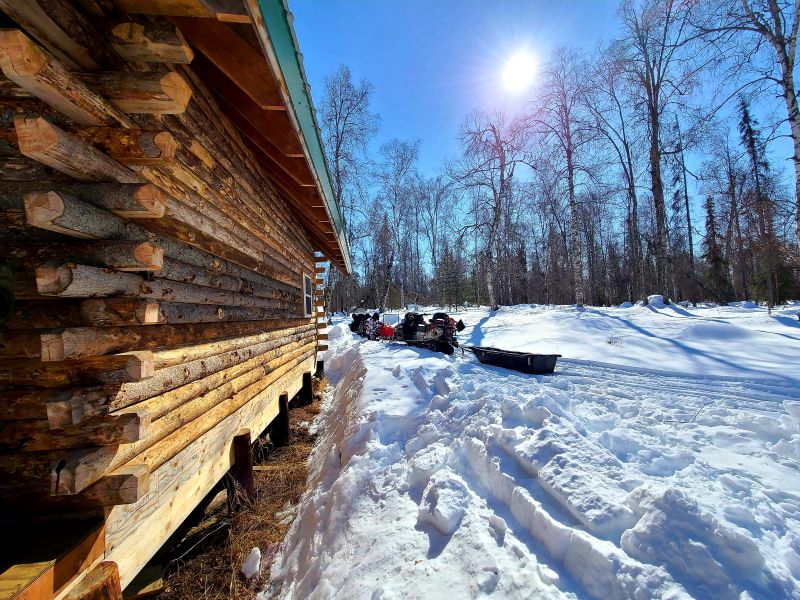

I use some cedar utility poles that were being removed for road improvements. They were in great shape when I got them and still are. Ranging in diameter of 12-18" across. They will be good for a long time.
Were remote also so getting enough concrete there for sono tubes wasn't reasonable. I did wrap felt paper around them n backfill with a cement premix. Easy to line up and cut off level. I cut a shoulder in and bolted a 6x12 beam in. It's made it through a 7.2 earthquake and gets over 4' of snow on the roof .
Still level n very solid
