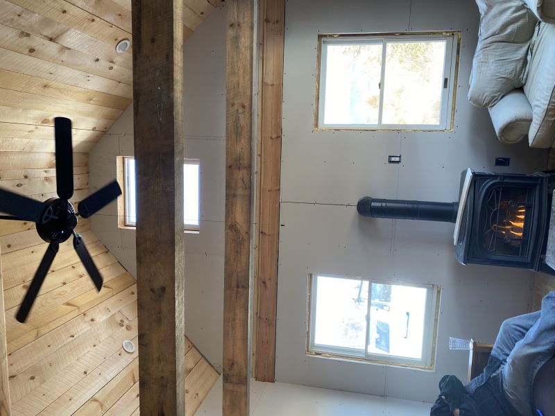

Drywall is obviously the cheapest option. However, except for the loft, lifting sheets up there ain't gonna be easy when my walls are 10' tall and the ceiling peak is at 18'. The only way i could make this manageable would be to run the sheets parallel to the rafters. For example, if you look at my attached photo you will see that my first leg is around 56" long. Since my rafters are 2' OC, i'd only have to lift and install a piece of drywall that's 56"x48".

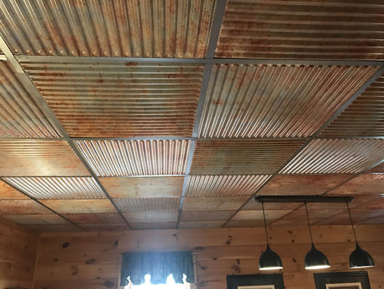

How about corrugated steel ceiling tiles.

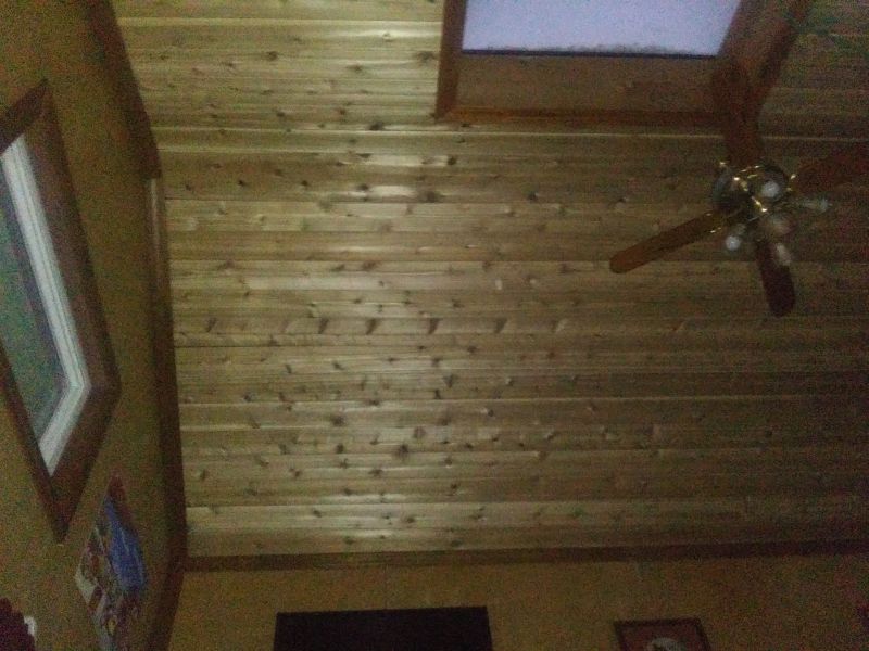

Yep, I got my cedar T&G from a contractor that completed a big house and had it left over. Did my cabin ceiling with about 10 boards left over. Light as a feather, simple to install. 600 bucks. 12x25.
