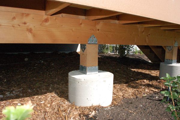

Im going with a 16'x24' size cabin. So Im wondering what kind of foundation to do. I am thinking of using sonotubes 8" or 10"? Im in Ohio and it said the frost line is 32"deep. Im seeing people are recommending digging a foot deeper. Which is fine but I was hoping to have close to 2' between the ground and cabin,for air flow and to be able to add plumbing later on if I decide to go that route.
Is there a way to add a spacer on the sonotube pier to get it up a bit higher or other options?
I plan to run 3 rows of tubes and use those metal mounting brackets on top of the piers. I was set to use two 6x6x12 beams and butt them up in the middle,but it appears this is a bad idea? Most people recommend nailing 3- 2x10's together and make your own beam.

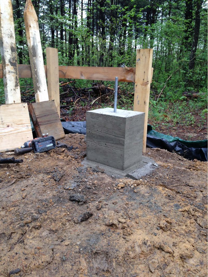

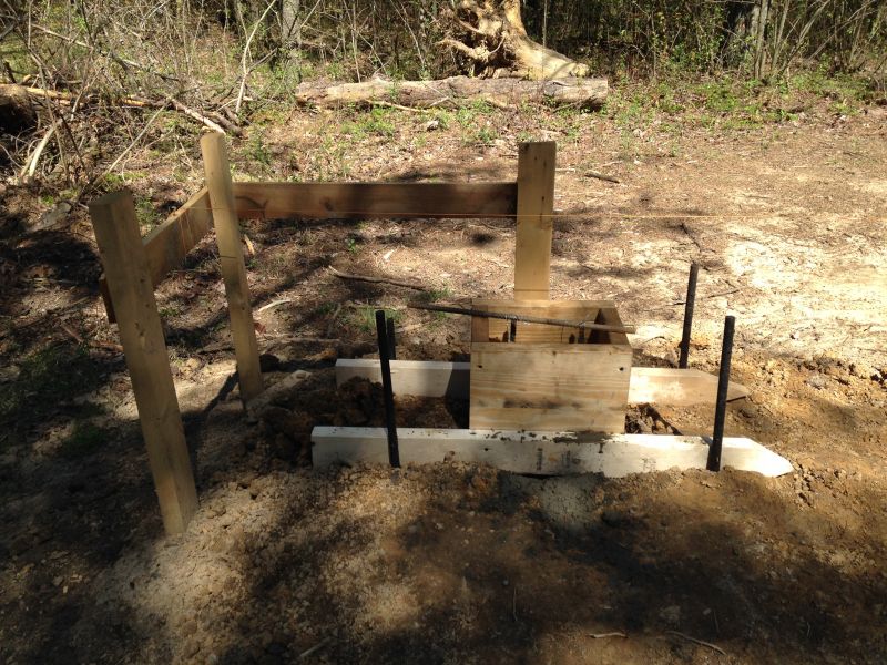

Take a look at the pics in my profile. I'm in Ohio. They show pretty much how I did it. I used a 12" auger
on a tractor to drill the holes in the ground, then formed up the top the way I wanted it to look. The Sono tubes could be used the same way, just set them
in place with framing. The top is what is most critical. You will have to set them all the same height, level with each other. I use a water level, which is a clear piece of tubing filled with windshield washer fluid. You use a long enough hose to get around to all of the tops of the forms. There is plenty of info online about it. I mounted the hose on a board so I could mark the location of the meniscus.
I'd pour a foundation or two each weekend I was at the place.
You'll have fun figuring it out.

# Posted: 2 Mar 2022 08:47am
I would think you could add a "leg" on top of the tube to get the height you want up to a point"

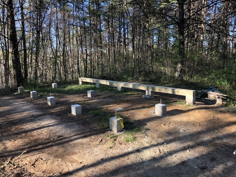

# Posted: 2 Mar 2022 09:30am
ProfitOFDoom,
Here is how I did it without tubes. I still have two
forms which I used throughout the process. If you want them, and you are close to Pike county, let
me know.
Tim_Ohio

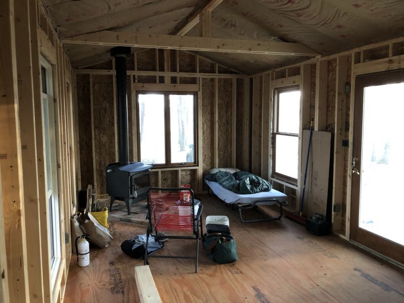

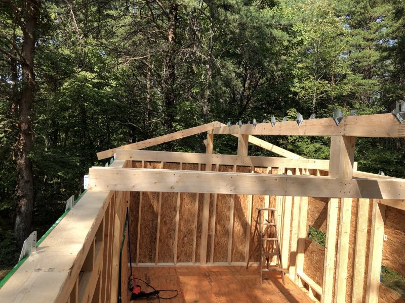

# Posted: 4 Mar 2022 07:53am
ProfitOfDoom,
Here are a couple of pics I can post, that are on this PC. The roof is a 4/12 pitch. I wanted it to be manageable for my 56 year old body, at the time. I was able to build all of the cabin, except for some help lifting the windows and the door into the openings.
I chose to span the cabin with a built up beam. I set the rafters on top of the beam. Since I wanted to be in the middle of the woods, I worried about a tree falling on it while I was inside and felt this would be the strongest way within budget to give myself some piece of mind. I insulated the ceiling with fiberglass having a paper vapor barrier. The walls were mineral wool. All framing was 2x6. All foundation and floor joists were pressure treated 2x8 material.
The beams were built up. It's solid. There is no bounce in the floor. Overall dimensions were 12x24'.

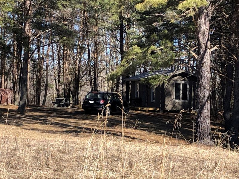

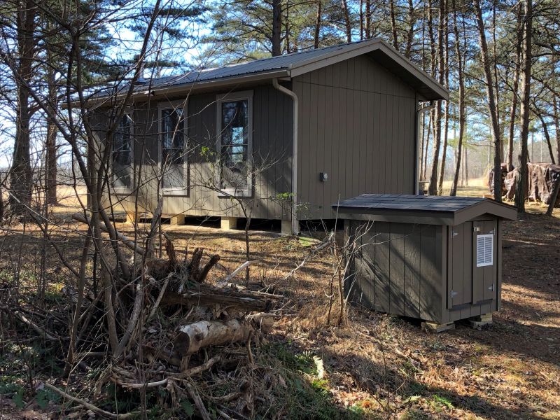

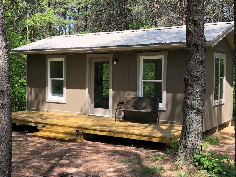

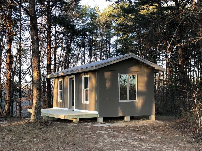

Here is an up-close picture after painting all of the pvc trim and adding gutters and downspouts. Then, the second photo is from a distance to show the environment and scale. I call it a camping cabin, since I'll probably never live in it. Although, if I get divorced a second time, it might come to that....hope not, but wouldn't mind too much, I suppose. The third photo is from the back, including the sound suppressing generator shed.

lburners
# Posted: 4 Mar 2022 10:14am
Very clean looking little hideaway.

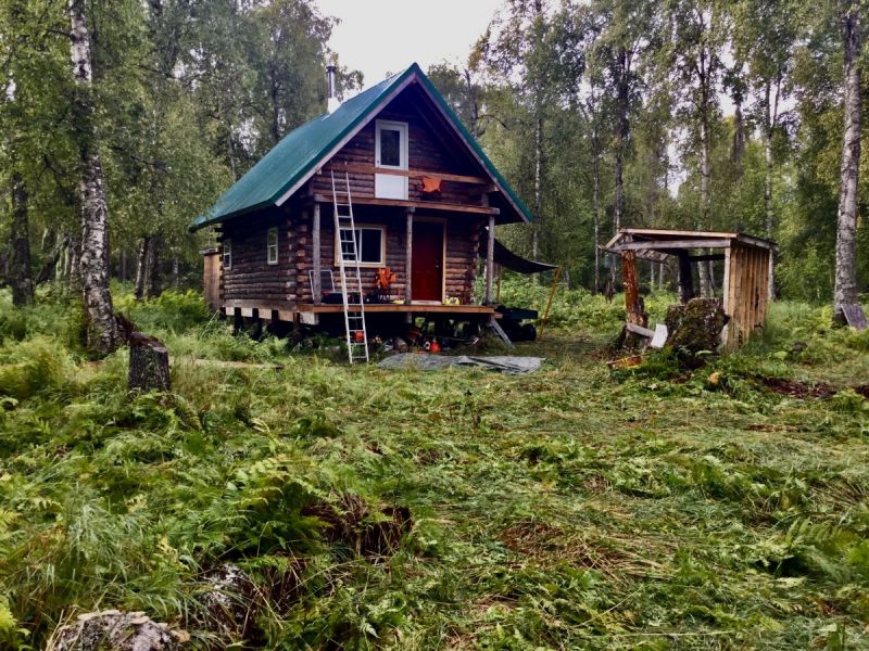

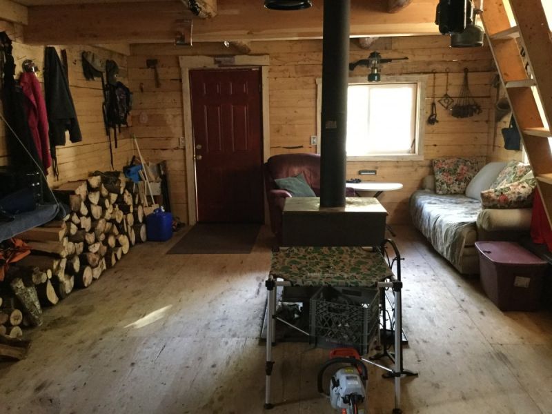

Profit of doom small cabin , kinda like the same thing. Figure your cost double it.
Hey welcome man. We built 16x24 using 3 sided logs. We used cedar utility poles that came off a highway expansion project. Get them out of the way. They made great foundation columns. Cedar doesn't rot and it's easy to cut the posts level so your floor Is level. I cut a shoulder in the top n bolted 6x12 beams in with 1/2" galvanized bolts. Very solid and has held level. It's been threw a few good earthquakes last being 7.2 that had such a shearing effect that a couple trees are tipped.
Couple of pictures of ours
