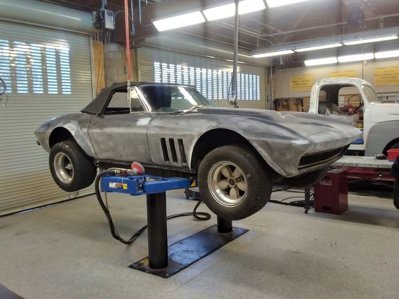

We have it at the auto shop. It has a rough texture, no slipping, and very durable. Spills are harder to wipe up though.
