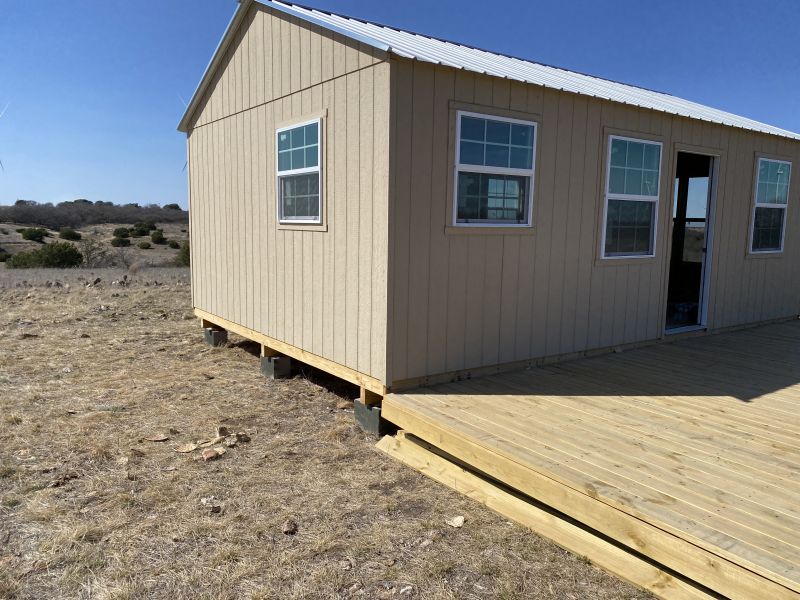

We are doing the small cabin thing in the south in an area that gets about 18 inches of rain a year. Its a somewhat arid place but I have seen some pretty heavy dew in the morning. There are a lot of hot days, and not many cold days so I am trying to run a small AC off a generator is the goal.
My Cabin was built on-site. The roof is not ideal but I dont want to take it off and mess with it if I dont have to.

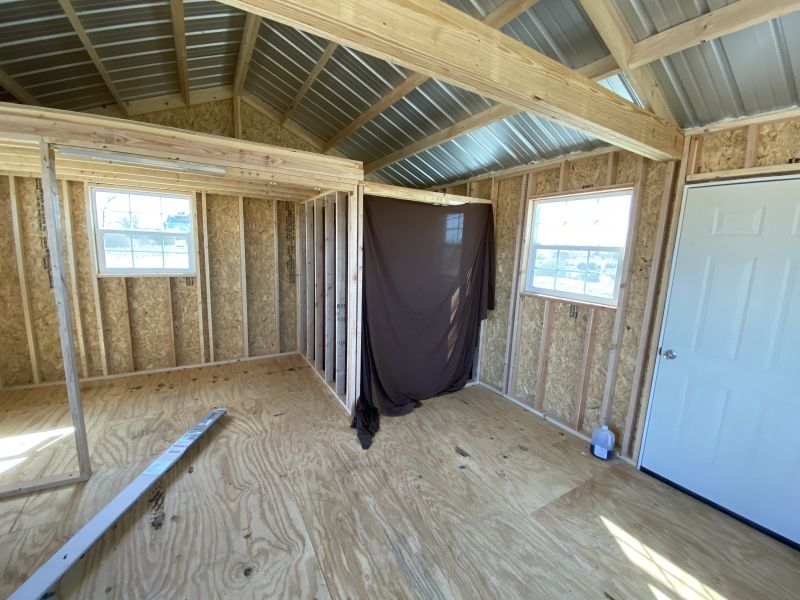

What i've got: 16x24 foot cabin, 2x6 roof joists, metal roofing directly on the joists with no underlayment. Has a ridge vent and gets some air ventilation through the ridges in the metal roof.
My plan to insulate it: My best plan is to put rockwool insulation between the joists and then put my ceiling on. Will this work? Some wind and bugs will get through on top of the insulation from the ridges in the metal roof. I dont want to create a fire hazard. My first plan was to shove foam block insulation in the roof but I moved on after reading that stuff burns good. Anyone have a better plan? The cabin was supposed to be built with 2x8 ceiling joists but the builder messed it up.

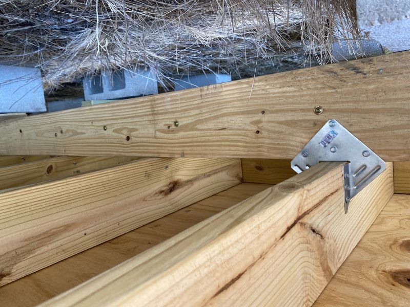

Also I could use some advice on the floor. What do I do under it to insulate it? Is my best bet spray foam insulation on the bottom? Right now the treated plywood floor is just exposed underneath as you can see in the picture. I was going to put some kind of laminate on top or vinyl planks seem low maintenance.

It looks to me like the way the ceiling joists were run as purlins (to support the tin), the only venting is in the ribs of the tin. That really reduces the air flow from the soffits. There is probably some calculator for how much air flow you will need (mostly to allow to keep it dry). I'm inclined to say, whatever insulation you use, a vapor barrier will be very important. Most of the water vapor that condenses on a ceiling (especially metal) is from inside the cabin. You will need space between the bottom of the tin and the top of the insulation to allow the air to flow. You may have to drill some holes in the upper most part of each "purlin" to enhance air flow,
before installing the insulation. If the insulation you choose does not have a paper vapor barrier, you will have to cover all of the ceiling with plastic and seal the seams. Even on the paper faced insulation, you will have to go back an seal the seams. If there is any water vapor passing through, it will condense on the metal, drip onto the finished ceiling below the insulation and cause a stain or cause rot. I like the paper vapor barrier since it has flaps for stapling it to the joists. I used it on the ceiling for this reason, but it's just a preference. Plastic over top of your insulation is probably way better.

Insulating under metal roof properly is prety difficult and much less with only 6in to work with. Your only real option if you dont want to take the metal off is foam. Either way it should really have a proper underlayment. What's going to happen is the warm air from in the building is going to leak out through bat insulation around the studs and condense on the cold metal. Then it will either drip, make mold, rot your framing or all three.
You really need to remove the metal. At that point I would put down 2in foam board ontop of the rafters, then underlayment for any possibly drips then the metal back on.

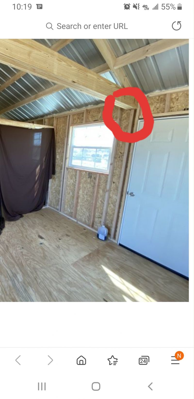

Also I see a huge looking beam in the center of the building..yet only 1 wall stud actualy supporting it? What ever stud is under that beam is actualy holding up half your building. Also when that single stud starts to sink your door isnt going to open because it's not framed as a load supporting wall.

Is spray foam within your budget for the ceiling? "Hot" roof - no ventilation needed, great insulation from both heat and cold plus sound.
Insulating the floor looks like a tricky process given you already have the floor down and looks like little room to get under. Likely easiest option (before putting in the floor would have been to Trim the cavities with ledgers and drop plywood in then insulation (assuming not much room to get under and seal from the bottom). If pests are a concern some sort of wire would be good as well. Given the current situation I'll be interested in options others come up with.

The budget is not bad, I can afford spray foam if that is the best option. I would rather not take the roof off as this is out in the middle of nowhere and I am short on help. But I also don’t want problems so if I need to slow down and rip off the roof so be it.
Also I can get under it to install whatever is the best kind of insulation. There is about 15 inches of clearance and I have been down there adding screws into the skids and hurricane straps.
Thank you for calling out that single stud holding up the cross beam. I will reinforce that. I was going to add some angle brackets to that connection but I will put another stud in there or a 4x4 or something to try and limit downward movement.

I could screw on some 2x4’s onto the joists to make them deeper. And then put in 2x6 rock wool and that would give me a few inches of ventilation. Any vapor barrier I do will be less than perfect. I will likely puncture it a little when I put some wood up on the roof.

I think, if you have enough air flow from the soffit area (not much to work with there) from the ribs of the
roofing, to the ridge cap (all of which should be open)
the natural convection current will move the air above the insulation. I used 2x4 fiberglass kraft faced insulation in 2x6 rafters and this left a nice space. However, I have a vented soffit/overhang (18"). My tin was on a wood decking on the roof, so the air flowed under that decking up to the ridge and out the vented ridge cap. I installed a ridge venting under the cap, not unlike a scotch guard pad (this stuff comes as a roll) to keep out insects and critters. The soffit I had was with holes for venting, so I did not need to use anything there. You could probably use this material above your walls to screen the openings of your roof rides
there. At least, that's what I'm seeing...I dunno, pictures are not always completely showing what's going on.

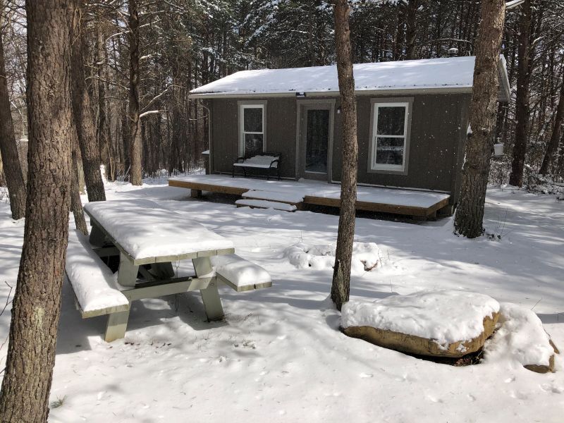

By the way, I was just in my cabin at 10 degrees Farenheit and the wood stove had it at 90.........I had to open the windows. This was with R13 in the ceiling, R23 in the wall and floor. The cabin is 12x24. All of the walls and vaulted ceiling are covered with drywall. Overnight,
I got up the next morning to see that none of the snow melted on the roof, not even around the wood stove chimney.
It's a triple beam, I'd support it with 3 studs.
Also, is that load transferred to one of the pads on the outside?
If it is directly supported by a pad it is luck. I helped laser level the pads and there was not much measuring going on. I will check it out and add supporting these to my list. There should be a pad within a few feet at this time.

You also need to support the bottom of the vertical stud under that beam..right to the ground.

The ribs alone are not enough ventilation. They make up a very small percentage of the actual pannel and metal can sweat a ton.

Get that cross beam fully supported ASAP, both from floor to ceiling and floor to ground.
Looks like your best option is spray foam. Not only for the reasons already discussed, but it also looks like it'll free up loft space. Space is at a premium in small cabins. Putting in a ceiling will cut out space you'll want to have. Also, I recommend you avoid removing the roof - not a good idea to unscrew and re-screw something that should be watertight.
UPDATE - just saw that the roof joists/rafters run parallel to the long wall. First time seeing that. Wonder if having all that spray foam pulling down in the underside of the roof will bow the joists down - they're spanning a larger space, and it doesn't look look like they're firmly fastened at the ends (although it's difficult to determine that in the picture). In that case, Tim_Ohio's recommendation is probably better.
For proper roof ventilation in this second scenario, you would need to have soffit/eave vents and vents at the top, the latter of which you appear to already have (a ridge vent). Typically with metal roofs like yours, there's a decent gap separating the 2 sides at the peak, and the peak "cap" if you will goes over it. That should allow plenty of ventilation at the peak provided foam closure strips aren't already installed. If they aren't, you can install screen on the underside of the gap and fill the gaps between the roof and screen with foam closure strips (and adhesive and staples) to keep bugs out. To further complicate that, though, it looks like you could have a beam just under the ridge vent. But, can't tell in the picture how much a hindrance that may be.....

The beam is getting supported on Thursday with more 2x4. This cabin is built on skids so there are 2x6’s under the beam at the floor.

2x6's under the foot of that load supporting upright doesnt sound like enough to me; ie, would think you need a support from under the 2x6's to ground?

I agree I need to look at how the walls are supported, I’ll shore it up with supports or another rail.
