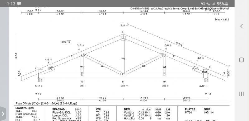

I have a very standard 5/12 pitch truss, 20' wide by 32' long roofline. It will be topped with corrugated, painted, 29ga metal roofing. No valleys, no crazy lines.

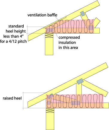

Since this is not built yet, have you bought the trusses yet? Were they spec'd to be built with a raised heel? (sometimes called an energy heel truss). They provide extra space at the wall for more insulation thickness without compressing batts and allow for easier ventilation. With sufficient insulation in that spot, the heat leakage that can cause ice dams to form can be eliminated. Then the ice&water shield is not as important. Here, we have been able to get code approval for a roof w/o I&WS if we use raised heel trusses and meet or exceed the zone required R-value in the ceiling.
Great question and points ICC.
The trusses have been paid for and built, just waiting on me to pick them up.
We went with a 12" energy heel on these. I am also planning on using the 4' black soffit insulation baffles between each truss to keep my insulation from being disturbed. (Photo attached)
No code to meet in my neck of the woods, but I want to do what is logical and sensible without throwing money away.
I am leaning towards the GAF Tiger Paw product across the entirety of the deck at the moment.
