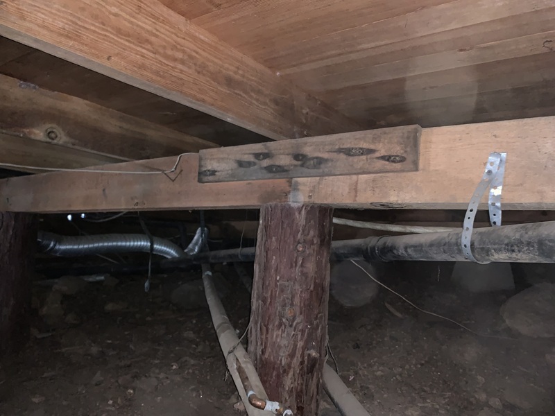

So, the toilet drain's not easy to get to, it turns out. There are foundation posts in the way. I'm stuck with it. The plan is for the plumber to remove the toilet, cut the pipe a bit from above, and re-attach the flange. Or maybe he'd have to put a new flange on, I don't know.
It could very well have been caused by frost heave, but also maybe by the sides of the house sinking. A flooring guy looking under the house noticed that the high spot in the cabin is in the middle, directly over the point where a girder is supported by a post. At that point, the girder is actually two different timbers whose ends are weakly joined or sistered, creating the conditions for a hinge effect. Over time, the cabin has sunk on the far ends of that girder.
Here's a picture. It's a close up, so it doesn't really show the crowning effect to the sides, but under there you can really see the bow. Maybe we can address it some day, but right now we're dealing with other issues and can't afford it.

If you ever think you might want to jack up and re-level the structure to match the high point, which you should, having cut off the sewer pipe will bite you.
Now that you have identified that issue beneath maybe use a laser-level inside (where it easier to check) to find out about how much lower all other points are from that high spot.
If that sewer pipe is already at about the right height if the building is jacked up Id consider making a temp 'riser' for under the stool for now.

I would love to be able to do it, but it's beyond my capacity to do myself. What does a new concrete foundation run? That's probably what it needs. The more solid cabins I see around the area have a concrete wall visible around the lower perimeter of the structure. We'll just have to live with the slopes of the cabin, I think.
# Posted: 8 May 2022 04:21pm
Lots of cabins do not have a 'crete foundation, and are level.
Imo, You need to research, and get tips here, on how to jack and re-level it. as the preimeter is sinking away from the high point the structure is slowly pulling apart.
