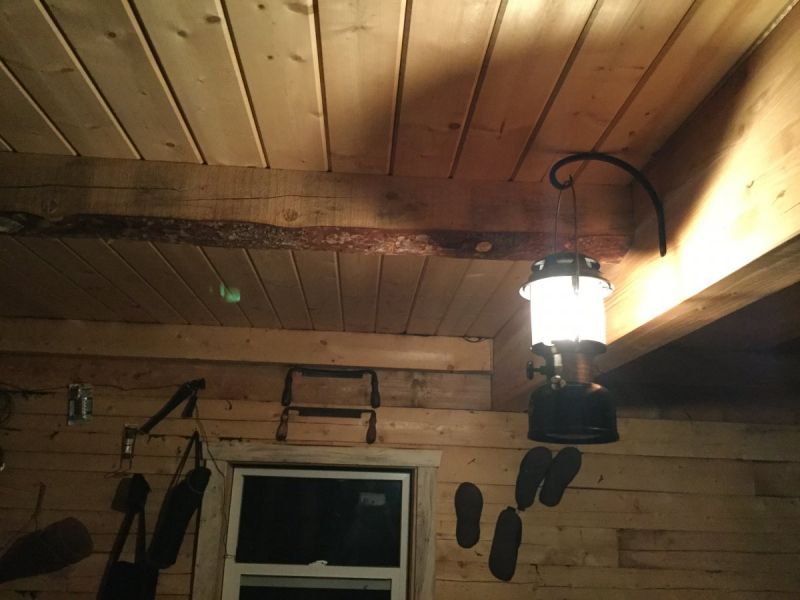

CV. Congratulations on the choice of build a cabin. If I read your post correctly I believe you asked if anyone has done tongue n groove flooring on the second level of a cabin so it was visible from below as the ceiling.
Yes on our 16x24 cabin. If fact we just freighted 200 boards out to finish the ceiling upstairs. I really like the looks. I'll post up a picture
