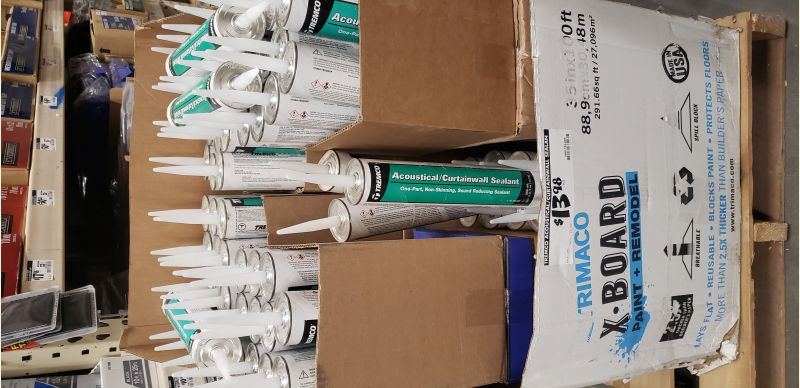

While gathering supplies I actually ran into the same problem, until I looked again.
My online search of Home Depot yielded no returns, but they definitely had it in store.
My understanding is this is THE stuff to get, because it never truly hardens. As you can imagine you don't want a fat hardened bead of silicone/glue right on the edge of your sheetrock.
I would encourage you to go back and look in person for this particular brand/product. Like myself, you may be surprised to find it everywhere when you know what you're looking for.
I actually ended up finding 3 cases (only need 1/2 case mind you) for half off because it was "expired" - which I think is stupid since it never truly hardens. Bought it anyways.
Here's a picture of the stand/product in my local HomeDepot once I finally found it. No idea why it wouldn't show up in the app.
Edit: picture kinda sucks apparently. If you can't read it, the brand is TREMCO. Product is "Acoustical/curtain wall sealant".
Good luck!

Thanks! What department/area of the store did you find it?

Paint! Right next to all the other silicone/caulk/glue tubes.
I also found it at a local hardware store the same day (Which made me realize I probably just didn't know what to look for). Probably should have sent my wife in She always seems to know right where whatever I need is when im at home!
