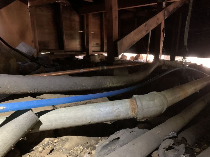

Thanks Tim (I'm from Geauga county originally). I'm in regular contact with the previous owner. But he's 93, and never really used the cabin much before basically leaving it to the elements. They bought it in '96, and stopped using it in '08. Their use was very intermittent. He really is a pleasure to talk to, but I'm basically on my own in terms of figuring stuff out. As I've found, that also applies to the important question: Where's the septic tank?!
I will check out the pitch on the copper pipe, gcrank1. The pex, you can see in the pic below, is like a roller coaster. That pex goes to the cold bib in front of the cabin. The copper pipe goes to the hot bib. The pipe insulation has fallen off the copper pipe, I think (I took the pictures a while ago...). The large galvanized pipe leads underground and, as far as I can figure, is either 1) an old cesspool drain line, from before they put in septic about 16 years ago, or 2) a conduit to a monstrous 8-ft diameter satellite dish out front.
