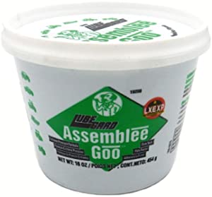

I had a friend gift me a jar of a slickum used in the automatic transmission rebuild shop; no idea of the name, back in the mid-70's. Iirc it was a special 'seal-goop' but he told me it was good for lots of things.
You may be thinking of Assembly Goo, I have a tub of it, lasts a lifetime. Great for holding parts in place while fitting things together, and dissolves in use.
