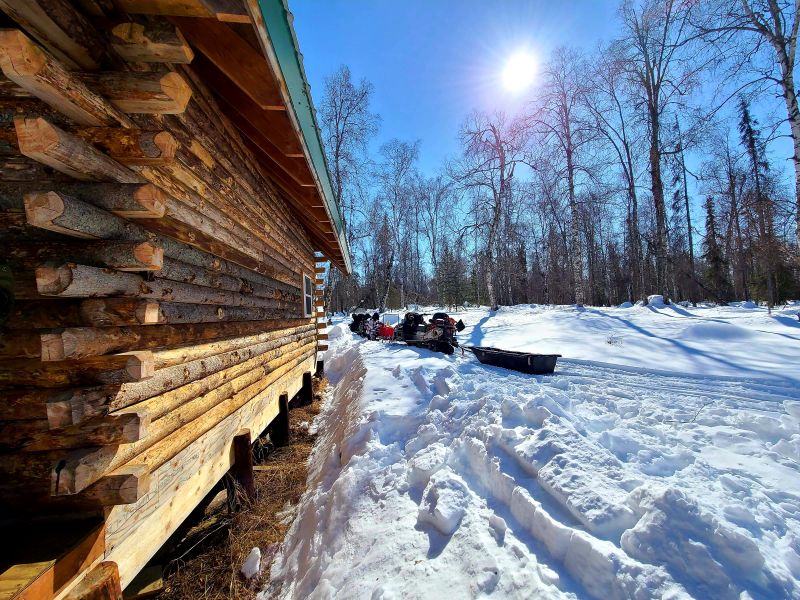

We used cedar utility poles for our remote log cabin foundation. They were very easy to get. Just stopped by aplace that installed poles. There's lots of road construction going on and they have to move the utilities. Maybe you could check out a road crew n ask.
Anyhows they made for an easy foundation. And cedar has natural oils in it that resist rot and bugs do not eat it. The bottom portion is treated, not sure if it's creosote as I believe that hasn't been used in a years because of toxins. I have not heard of creosote deteriorating but maybe it does. I do know that the poles will last a long time. I wrapped tar paper around mine, not so much concerned about ground contact as having the frozen ground having something to grab in to. And cousing hydronic jacking or frost heaves.
After the poles are in. A laser level will make cutting them off at the correct hight is easy. I cut a shoulder into the top of ours to hold the floor 6"x12" beams and bolted them with 1/2" galvanized bolts.
So putting the poles in and leveling out the cabin floor was easy. And I was able to get the poles out using snogos in the winter cut to 8' lengths.
Our cabin has stood through 7.2 earthquakes and 12' of snow yearly and the floor is still perfectly flat. In fact I just checked it a few weeks ago. Been up 10 years or so now.
My suggestion would be used utility poles for remote work.
Side of cabin
Side of cabin
