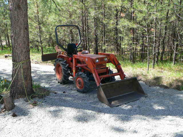

Find a neighbor with a skid steer or a small 4wd tractor c/w bucket? Their already developed skills will make it go way faster. Offer to pay 'em what the day rental would be.
There is generally more to graveling a new driveway than dumping gravel if you want it to be good.

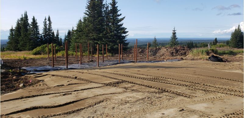

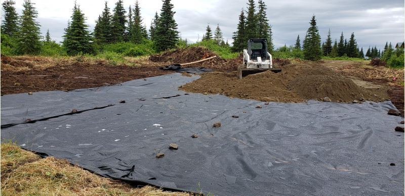

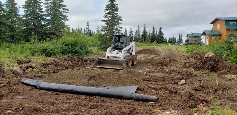

IMO - the best bang for your buck is gonna be a skid steer. You can be competent with it within an hour and they are fairly forgiving. Theyre not so big so you won't end up doing more harm than good. A tracked rig will be easier for level spreading than a wheeled rig, but it is certainly possible in either. Locally rentals are about $350/day here, although there are personal rentals that can be had for $250/day on classified ads. Schedule it over the weekend to grab those free days whenever possible.
Personally I have an 863 Bobcat and I've mined, moved and spread 200 yards of dirt with it last summer for my driveway/ pad. It's a 150' driveway with a 50x60 pad, about 12-16" deep.
When spreading it's all about the angle of your bucket. More forward to spread the dirt, back drag it to flatten/pack it. A steep angle on your bucket while back dragging will cut the high spots, a low/no angle will smooth everything.
Get the surface fairly even then spend 10 mins tracking it evenly, then repeat the process.
In terms of starting I suggest you scrape off the organic layer (top 8") and dispose of somewhere out of the way. Then as mentioned above, put down geotextile/typar down before your road bed material. It's gotten spendy in the last year (doubled in price locally) but it will save you big $ in material and really helps from things getting rutted out.
Plenty of YouTube videos out there to watch and learn from as well. Best of luck!

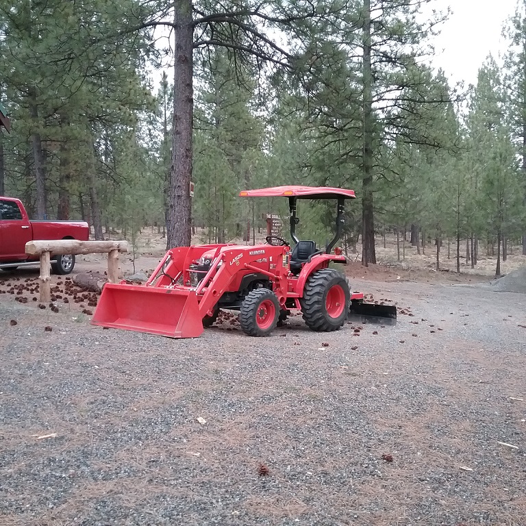

I have my gravel guy tailgate it in, got about 200 feet with a loaded 10 yard truck, did a perfect job.
In tighter areas, we moved it with my cousins little 15HP Kubota, I have since purchased a new Kubota in 2017, good investment.
They always have 0 down and 0% financing, though, the financing may not be 0 anymore.
I do have a brand new Kubota 72" box scraper for my tractor too. Next option/implement is a landscape rake
Cuzs 78 Kubota
